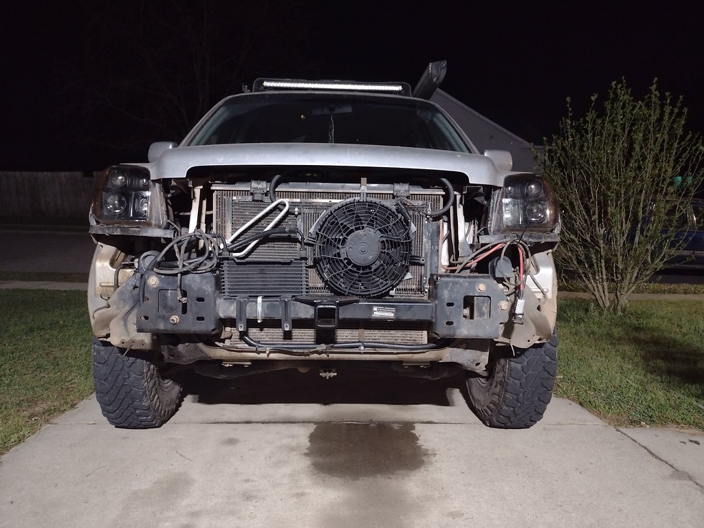

Here is my current Transmission cooler setup. It took creativity and cutting to get it all to fit under the grill cover with my custom front hitch receiver. I used two Hayden Automotive 678 Rapid-Cool Plates that I already had and installed them vertically under a pusher fan that I salvaged from a Landrover. I have foam between the cooler plates and the radiator and between the fan and the cooler plates. The fan would not fit under the stock power steering cooler so I converted it to a cooler plate from the salvage yard.
The fan is wired to a 180F inline fan thermostat: 180F TRANSMISSION OIL COOLER FAN THERMOSTAT SWITCH KIT 6AN IN-LINE HOSE ADAPTER | eBay which turns the fan on when the trans temp hits 180. It also allows an over ride to be wired in.
