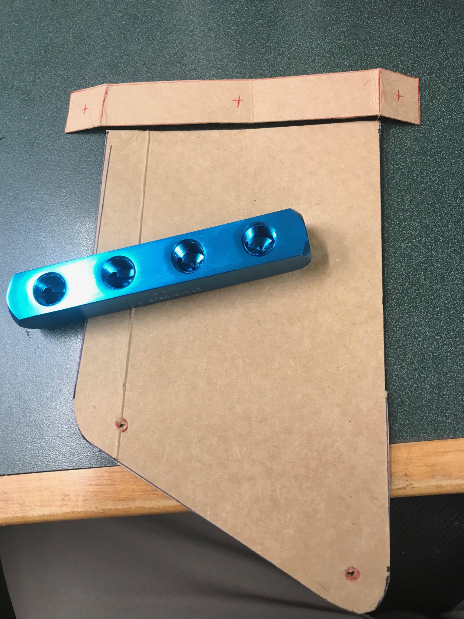

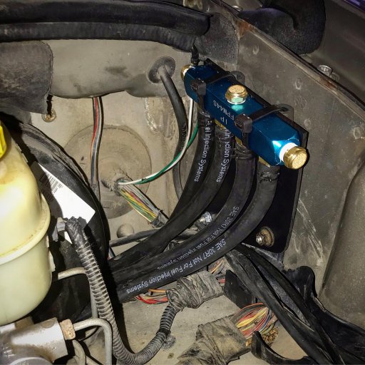

Slowly working on a mount for my DIY breather extension mod. This heat has not been conducive to working outside. CAD (cardboard aided design) is helping with fitment of the bracket to mount it to the rig, but I'm sure I'm going to have to suck it up to finish it anytime soon.

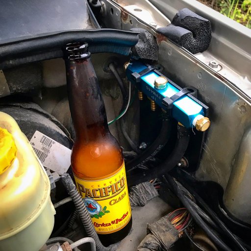

This is what I have for my breather extension mod. I toyed around with about 4 or 5 different mounting locations, but this one offers the easiest access and is as far back as I can get it without drilling into the firewall. I initially wanted to not use this spot for a possible future mod of the washer reservoir, but with the bumper and tire combo I plan on ending up with, it shouldn't be an issue. If anything, I'll build a reinforcement plate to keep the tire from contacting the washer bottle.
2 pieces of cardboard. The larger is the plate to mount to the vehicle utilizing existing welded bolts, and the other is how I plan on mounting the manifold to the plate. When I cut the sheet metal, it'll all be one piece with bends to accommodate the second piece. The two squares on either end will be a bend to wrap around the ends. The "+" are my drill centers where I will drill out to match the OD of the sintered vents on both ends and the single port on the other side. I might have to shim with washers to get a good tension between the manifold and my mount. I plan on utilizing some rubber between the plate and the vehicle to reduce vibration.

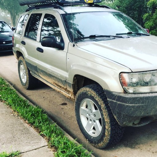

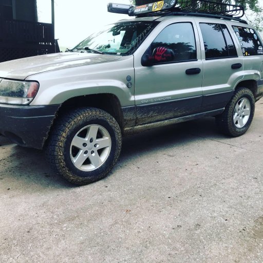

Time for a WJ update! It has been sitting for a bit due to many other distractions, but we turned our attention back on her over the last week or so. First, it got a new starter, followed by a transmission fluid/filter change. I also had the power steering fluid flushed/filled and leaky hoses replaced. I'm trying to prevent a $1,000 replacement of that fancy hydraulic cooling fan, so this will be a routine thing every few years. It also got a new oil pressure sending unit. It runs like new and is VERY strong. The idle is smooth, but I'm still going to replace those O2 sensors at some point. It is sitting on about 104,300 miles, so it is nice to feel the engine/transmission performing so well. Lots of life left in this baby, for sure. We'll be changing the oil in 1k miles, as the previous owner changed it right before we bought it, so it is still in good shape. We've got some nice Pennzoil Ultra Platinum on deck with a Fram Ultra filter. That should do good cleanup duty, then it will get a steady diet of that or Mobil 1 from here on out. Oh yeah, the diffs are going to be changed soo, too. The rear looks like a little bit of a pain to get to, but we'll figure it out. I may have to jack it way up to get the suspension to droop enough to access the top bolts. It'll get some fresh Valvoline or Napa synthetic gear lube.
Next up will be a tire rotate/balance. We were thinking about JK wheels, but my son likes the 16" wheels that are on it, but they are chewed up with corrosion. Anybody know how much it costs to get a wheel refinished? If around 100 bucks each, he may get that done, one or two at a time. Otherwise, we'll Plasti-Dip them either black or a metallic color. We'll be running these Goodyears awhile. They are new, so why not? He also wants to get a roof rack. We've got front tow hooks, so I'll be painting them red and we'll install them this winter. I also want to put a hitch on it. I know there was once a recall for potential fires from the gas tank in a rear end collision. Jeep recalled them and put hitches on them, which offered more protection. I wonder if they'd still perform that recall? If not, a hitch isn't too expensive. It will cost a little departure angle, but will provide a recovery point for the rear, so it is worth it. Ultimately, I'll ut a new gas tank skid on it, too, as the current one is somewhat rusted. We'll also be installing a Pioneer 7" head unit with Android Auto so he'll have navigation.
Tonight, we gave it a thorough wash and threw a coat of Turtle Wax Ice paste wax on it. This made the previous owner's cheap Mako paint job look pretty good. ONce the wheels are refinished or dipped, it will look great. I think it is also almost ready for its Trail Rated badge!
Anyone know a good value roof rack/basket that would work with these stock roof rails?
Here are some current pics from this evening.

Finished up the breather extension mod. FINALLY! I gave each diff some slack for flexing, but everything is secured with 200lb test zips. OEM vents on the rear diff and trans seem to have been clogged or just rather dirty give a little fluid buildup on the vent and around the barb. Cleaned all of the barbs up before installing the hose. Could not get a clamp on the trans barb due to the location and lack of space. I had to set the rig on jack stands and droop the front axle completely to fit my arm between the floor and driveshaft to get to the trans vent. Rear diff line spans the length of the vehicle and is secured to the fuel and brake lines. Front diff is secured on the driver side LCA via the factory clip. trans and tcase lines are zipped together following existing lines/wires. I wrapped the lines in a heat reflective tape at the spot near the engine block and header to avoid any potential issues. Might be overkill. Might not. At least this project is done and I am pleasantly surprised at how easy it was to do all of this once the mount was made and the supplies were all purchased. For reference, I used almost all of the 25ft spool of 5/16th's fuel line, 7 spring action hose clamps, 4 1/4NPT 5/16" barbs, 3 1/4NPT sintered bronze vents, a 7 port pencil air manifold, about 1/3 of a 12"x12" sheet of kydex, half a package of 200lb test zips, some of the old breather line, and heat reflective tape. I still have enough kydex to build an electrical mount for cleaning and simplifying my lighting, and I have enough vents for 1-2 more to do this, and I have a ton of high quality zips.

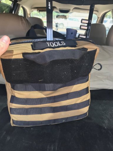

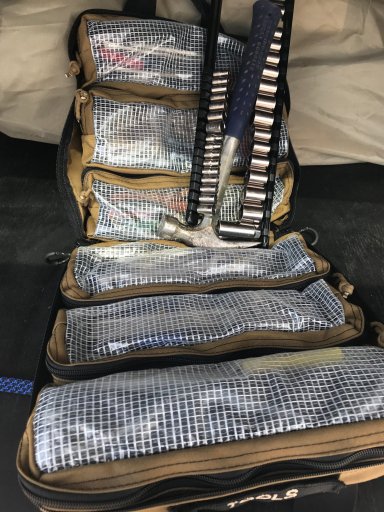

Forgot to post this thing up a while ago. BROG tool bag is a game changer. I haul nearly the same amount of tools in a smaller, more packable form. The big tool bag was nice but after my trip to AZ for Expo and the Grand Canyon, I realized it was just taking up some unnecessary space, which of course can and is being better utilized now. The old tool bag is still in use as the house tool bag. The BROG tool bag fits perfectly between my platform and the wall of the rig. I do need to cut down the socket rails to fit better and probably reassess what is in the bag, but it works well!

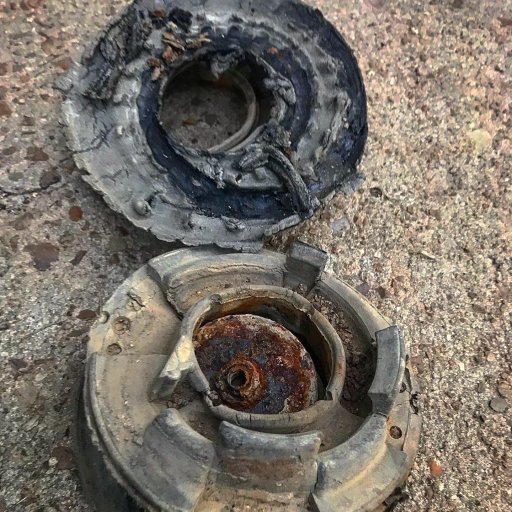

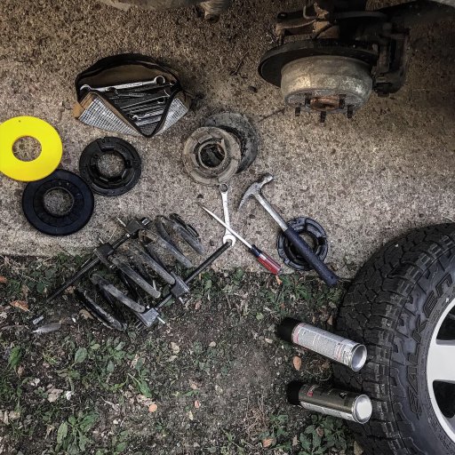

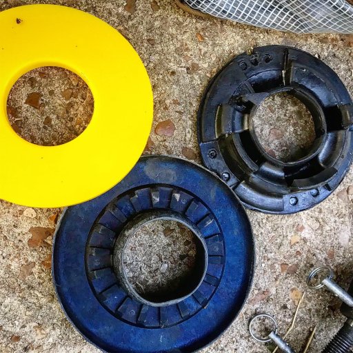

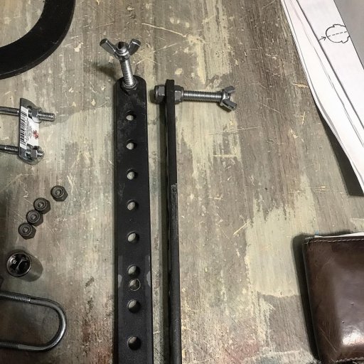

Sorry for the lack of updates. Been busy with work. I did knock out a couple small projects within the past few weeks. Got the rear suspension sag issue resolved with some new spring isolators (upper and lower), as well adding in a trim spacer on either side of the rear to compensate for the leveling effect of the front spring perches I welded in when I initially leveled the rig. LONG overdue for sure but it's done and rides a bit better. I did clean up any rust I found and shot some paint on it.
Here's a comparison of the new vs old. Id's say they were worn....

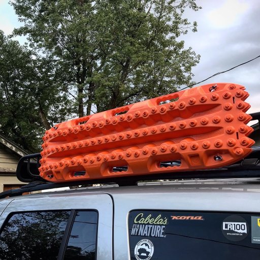

Second project was snagging some ActionTrax. USA made and the quality seems to be pretty darn good too. Built a mount out of some scrap metal and $10 at the hardware store. Not sure I like how high up they sit as they tend to act like a sail in the wind...so I will have to re-drill a couple holes to drop them down.

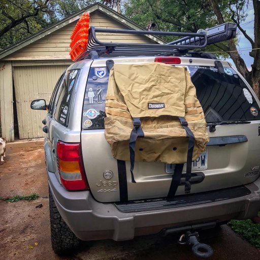

I did manage to figure out a way to mount my trasharoo without the spare tire carrier so this will work until I get the spare on the outside of the rig. I might also mount my trax to the spare behind the trasharoo like many seem to do. Food for thought.B8F42A71-6477-487C-B4E4-447DDC93205F.JPG
