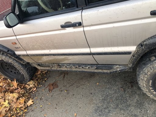

Thank you! I’d highly recommend the sliders. Dark crow designs out of Ohio. He makes them rounded or squared off. If you’re willing to do the priming and painting yourself, it’s a way to save a bit over the tactical rovers(which I really wanted) or RTE ones. It’s a physical install, but once you get the first one done it’s easy.
Ha... it can’t be as hard as swapping out the transfer case. That was a bear. I thought about just doing the output shaft swap like you did, but I have an ‘02 and the‘04 case I got looked to be in great shape has lower mileage on it. I’m glad I swapped the entire case though. The Ashcroft CDL was a good call, even though it was pricey it works great.

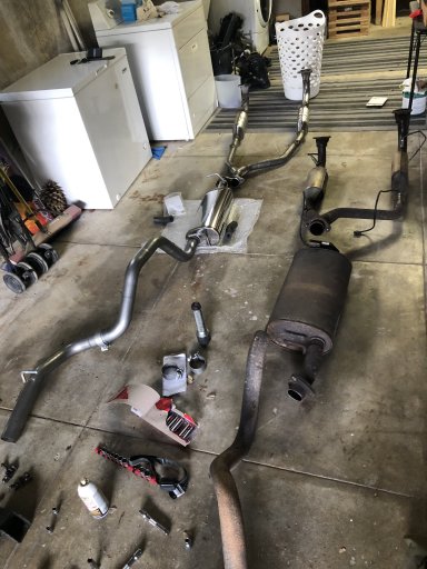

Latest update. Got an o2 sensor fault and had had some misfires in the past, so decided to replace the whole exhaust system while at it. Put in the magnaflow cats, muffler, and cat-back. Sounds awesome. Probably placebo effect, but pretty damn sure it's got a little more giddy-up on the hills now:

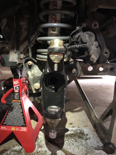

Have a steering groan while turning right due to worn out ball joints. Got a quote to replace them for $1500 (gotta love the bay area). Used this quarantine time to replace the ball joints and put in new hubs. Most physical thing I've had to do to this truck so far. And I'm only half way there! Took me snapping off two 1/2 drive breaker bars to realize I needed a 3/4 drive breaker bar and socket to loosen that axle nut. Lesson learned.

@disco_unchained looking good man. Only thing I’ve gotten accomplished is installed the rear bumper. Mines been throwing random misfire cylinders. I need to dig in and change out the coil packs. How’s it running with the new exhaust?

I had those misfires at about 70K and changed out the wires to the magnacore's and was fine after that. it's a bitch of a job if you have the SAI though. Good luck! Re: the exhaust it feels like it has a little more pep. Got a bit of a rattle as the rubber mounts were pretty shot. Ordered some new mounts to fix that.

...it took a 3/4" to crack it loose? Woah! Good to know, maybe I need to upgrade my kit now before I get in the same sticky situation :openmouth:
