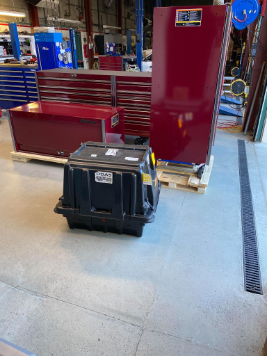

Motor came in today (and my buddy who's been helping me work on it's new Snap On boxes - all 4 of them, they're worth a loooooooooot more than my old WJ lol).
-TJ
