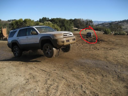

Here's how @tjZ06 and I treated this thing back in 07
Here's how it sits today after a decade and a half of grandpa duty

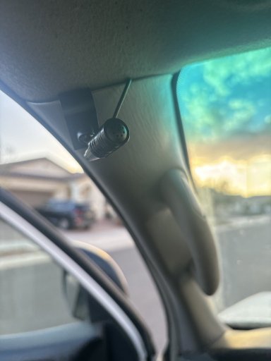

Easy work today. Glad it’s easy because I’m going to have to pull it all apart again to plug the mic into the right input on the receiver. Had to move from a CD/tape player to a modern stereo with CarPlay. I’ll probably buy an SXM module at some point too
I drilled a hole and placed the USB input here. Zipties on the top and bottom of the ferrule keep it from moving
Mic is placed here
