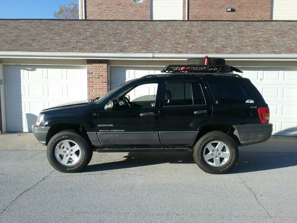

I can dig the emblem. I have one that has a mountain scene on it and says est 2004 since my WJ is an '04. I'm considering the OME lift. it's about a 2in lift but I'll get HD springs for all the added weight on the rig. Hoping for good driveability
I nearly got an OME lift but I ended up with the IRO. I think the Rocky Road OME lift comes with lower control arms and you can option in Bilstein shocks. Those additions might make all the difference in driveability. [emoji106]

I don't want a ton of lift as it's still a DD and I need to maintain the driveability for longer stretches. I've considered different shocks, but the OME come highly recommended. Still unsure. I'm looking at those IRO skid plates and trans cross member you added for extra clearance and protection.
I'm kind of in the same boat as you. I don't DD all the time but I wanted it to be great on the road because my last 2 round trips to see my folks were 1500 miles each time. That will be the true test. I have a friend who's like a little sister and she just bought a WJ. I will probably steer her towards an OME kit for the reasons you stated.
On this trip to the ranch I purposely high centered the WJ to see where it would hit. It was pretty much right on the IRO skid plate. [emoji108]

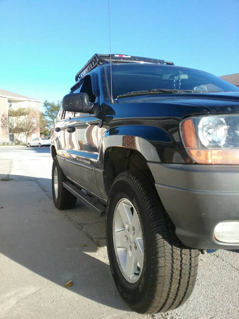

Got my JK wheels off a 2015 Wrangler put on today. 255/75r17 tires basically brand new. Couldn't be happier! The WJ rides better and I have no rub at full lock without wheel spacers. I'm really happy to not have to use spacers.
