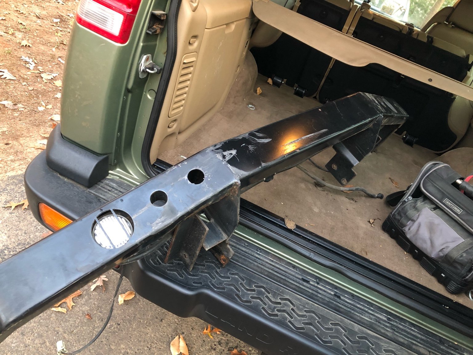

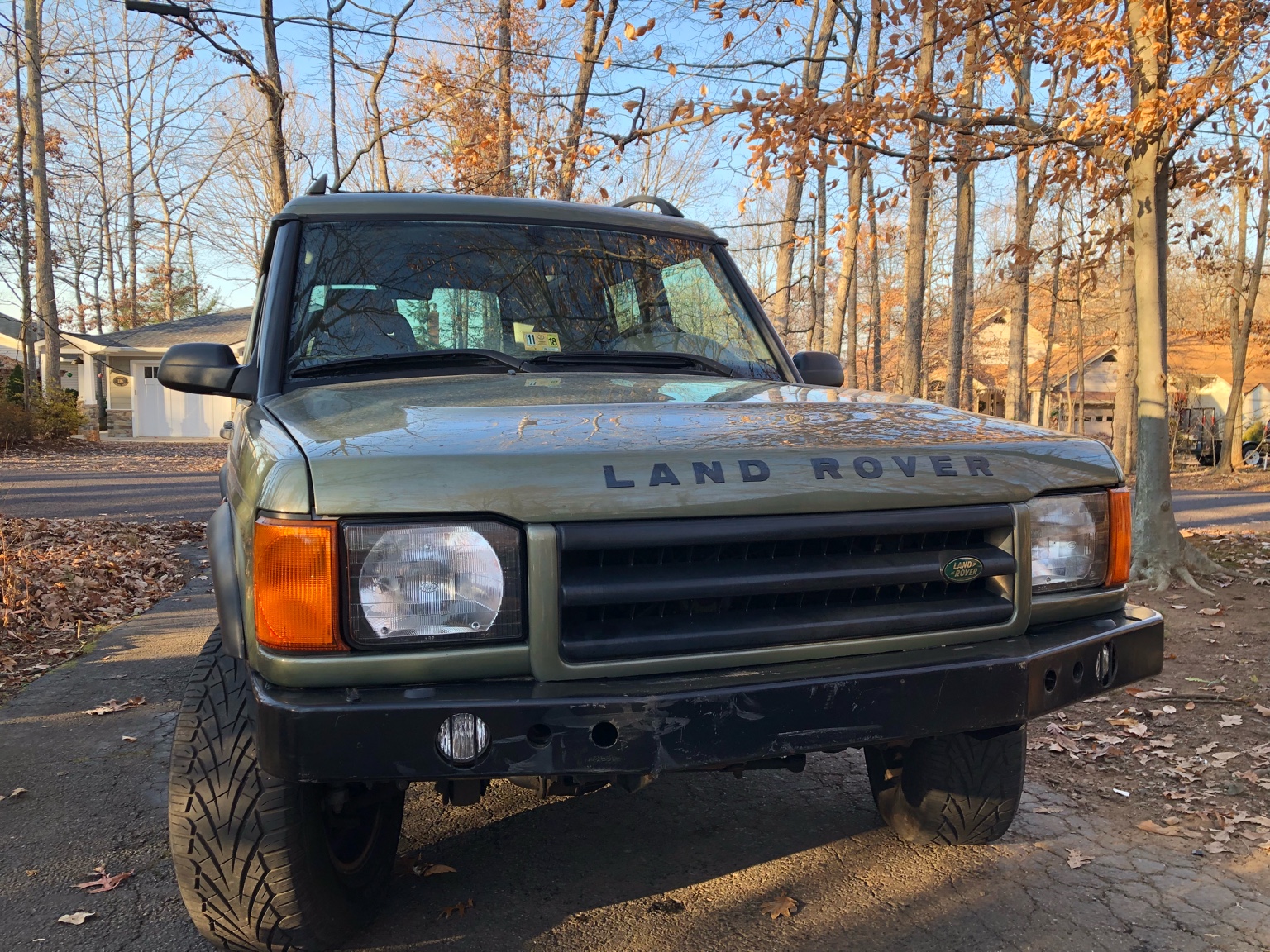

Well I got the throttle body heater plate all installed and the truck is running like a champ. I went to the junk yard today to see if I could find the CDL linkage from a 2004 disco to put in mine and Though i didn’t find one at the yard I went to today. I did however find a front bumper!!! 60 bucks! I was so shocked to find one in near perfect condition! I’ll install it and upload pictures.
