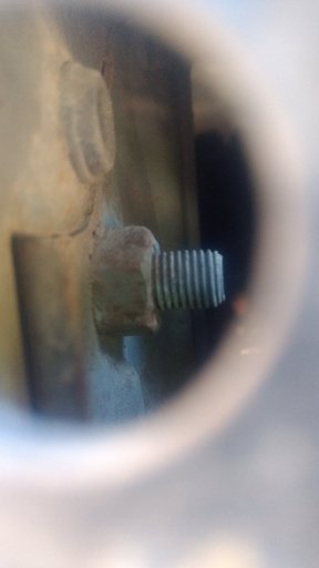

In skimming over this thread, I realized that I neglected to mention and show one of the most critical mods I've made to the CR-V!
Namely, two 10,000lb rated recovery hooks bolted into the rear "frame rails" of the unibody:
These are bolted into the holes where a hitch receiver would be mounted. If I ever need recovery or need to tow or snatch someone, I use a bridle linked between them to attach the strap. This is to spread the load between the two points instead of relying on only one. The white goop is sealant i added to ensure it didn't rust. I also sprayed the holes with paint, as I had to widen them slightly to fit the bolts.
If you have a hitch receiver, you just need to get a shackle mount to insert into it. Never recover off a tow ball! In my opinion, a 2" hitch receiver would be preferable to what I have here, however once again the budget intervened. These were like $15 at princess auto for the pair, while the hitch receiver was a couple hundred at least.
I have used these recovery points before, and they have held up just fine, but as I mentioned, if you have the cash, the 2" hitch receiver with a shackle mount is a better option for ultility, and is probably marginally better overall, as it spreads between three points, since it bolts into the tiedown point in the middle under the tub.

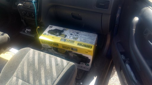

Looks exciting! Did you consider a portable winch as a solution? I am wondering which winch would work well when ..... wrequired.
I considered all kinds of different ideas lol
I've seen some footage of a guy in Ontario who mounted a 3000lb winch upside down on the factory bumper core winching himself out of a pretty deep, nasty, steep bog hole with no issues. This setup is going to be significantly stronger than that, and although a little short of the "1.5xGVRW" formula, I reasoned that on a lightweight unibody there's some merit to the notion that the winch is going to fail before tearing the car apart lol

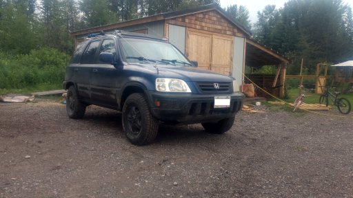

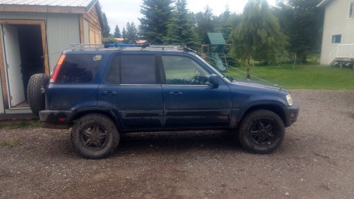

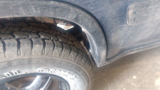

New shoes on:
It's a little tight, but under normal driving, it doesn't rub. I think more bashing with the BFH and possibly a spacer on the trailing arm pivot to move that tire back a bit. Overall very happy.
I also went out to the bush and did a little hill climb to test out how much power and torque I lost from the bigger tires. I would say it's only barely noticeable, perhaps the slightest difference, but I for sure would never go any bigger than this size on this vehicle.

I went with 235/75/15 on the stock alloy wheels. It doesn't rub under normal driving, but it's tight. I'm probably going to massage the wheel wells in the back and probably put a spacer on the trailing arm pivot to make a bit more room. There's a slight loss of power with these tires, but nothing too serious. I surely would never go any bigger.

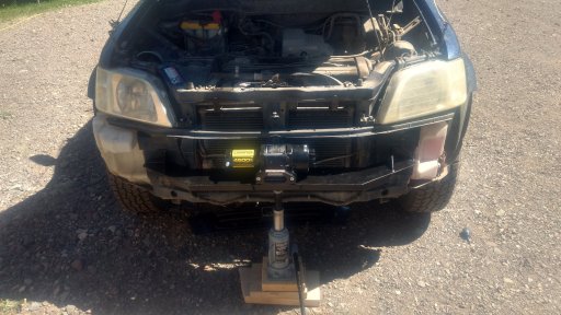

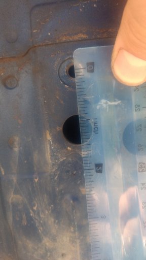

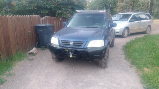

Did the first trial fit today, and I was absolutely stoked to find out that the vehicle has a 1/2 hole from the factory that sits in just about the perfect spot, AND which perfectly lines up with the big fat bolt at the top of the factory tow plates:
Amazingly, the bolt holes for the four bolts that originally held the bumper core on were almost perfectly aligned. The bottom two were perfect, but the top two needed a bit of filing to make them work. Still, got it bolted up:
I'm not too happy with the cut I did on the bumper skin. Having said that, it was already cracked in a couple of places anyway, so I'll go to the wrecker and get another one. I have a good idea where to cut it this time to make it look way better, and leave more of the original skin on:
For now, it's just a poser winch lol But soon I'll get it all fully bolted and tied into the frame rails, a new skin cut that shrouds it more, and of course get the wiring all done.

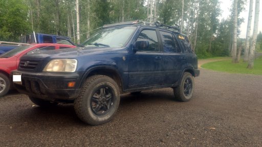

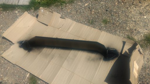

Well, got everything wired up, the synthetic rope tensioned on the spool, and the bumper (re)finished. Rockauto wanted to charge me $750 for shipping a $58 bumper skin, Lordco wanted $450 for one, and the two local wreckers wanted $100 and $200 respectively, so I decided that drifter's stitches were the way to go. Actually turned out pretty cool, if I may say so. Would have been better if I had cut it this way in the first place, but oh well, live and learn.
I've done some more research into the construction of the unibody on the CR-V, and I'm reasonably confident in this mounting solution just relying on the 4 high tensile M8 bolts into the front of the frame rails. Those pieces are fairly substantial and are welded quite thoroughly. Having said that, I will probably go ahead with my plan to reinforce the mount by tying into the frame rails through the top bolt that holds the recovery points on, but I just haven't yet been able to find the right bolts yet to make it work. It's a matter of being 98% confident now, whereas when I add the eye bolts in I'll be 100%. I wouldn't be sweating using this current configuration unless I was pretty savagely bogged, which I never have been.
Tomorrow, the skid plate goes back on with washers in place to accommodate the 1/4 inch engine drop. I also need to rig up a flip up license plate solution to allow access to the winch.
