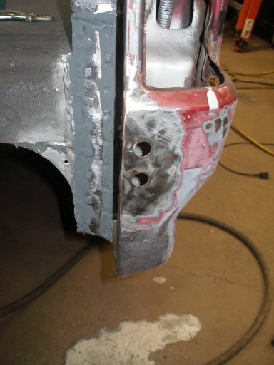

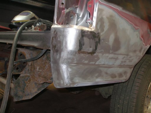

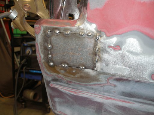

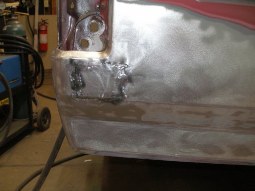

Removed to bracket that the old spare tire carrier mounted to and cut out some rusty cracked metal.
First patch tacked in place
First patch welded up and smoothed out.
Second patch tacked in place.
Cleaned up and sanded.
And added some epoxy primer to the mix to seal every thing up for the next step.
1,250
Hartford, SD

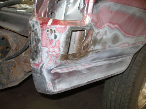

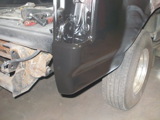

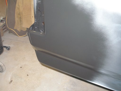

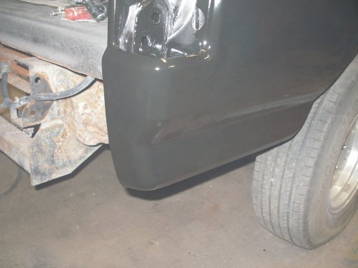

Managed to get some filler on the rear panel and some sanding done.
88520
And after some more primer and some finishing glaze it was time more sanding!
88521
Then it was time for some cleanup and to seal it up.
88522
88523
Turned out pretty good. To bad I'll probably scratch it up or dent in with a year or 2 of use.

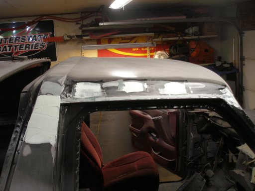

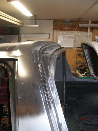

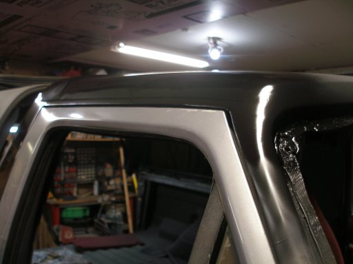

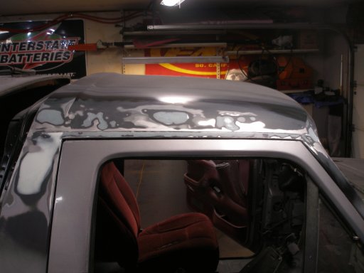

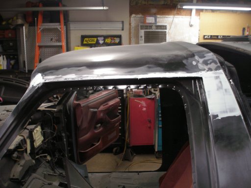

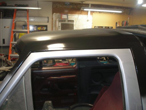

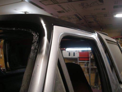

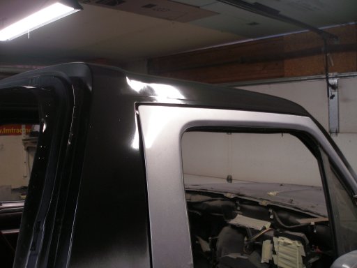

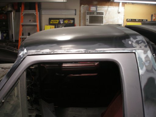

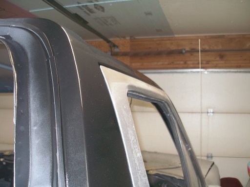

Then it was back to the drip rail delete project. After some epoxy primer and some filler on both sides. I had a few dings on the passenger side I smoothed out as best as I could with wood and a hammer. Then some filler to smooth it out the rest of the way.
88524
Drivers side was in better shape. Didn't need the hammer and less filler needed to smooth it out.
88525
After some sanding.
88526
88527
Got it all smoothed out and put on some more epoxy primer to seal it up.
88528
88529
88530
88531
88532
So far so good. It turned out pretty good for a clown in his garage.

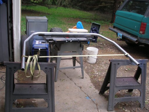

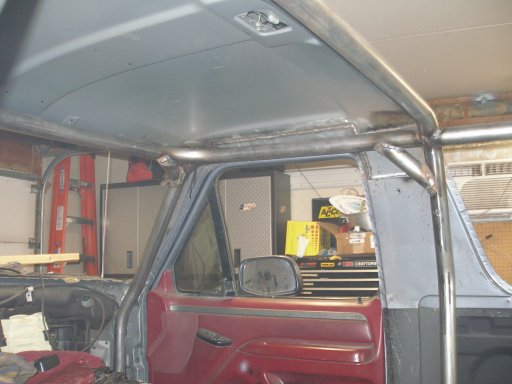

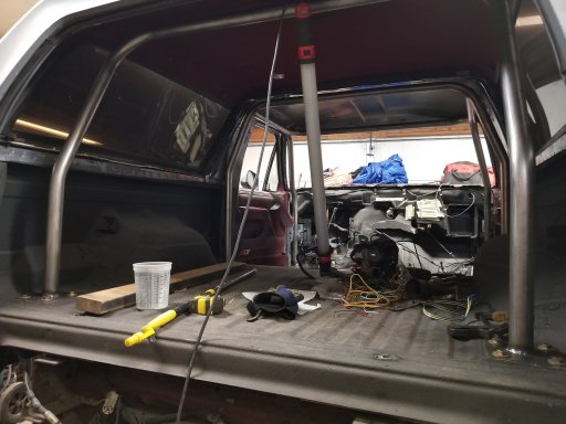

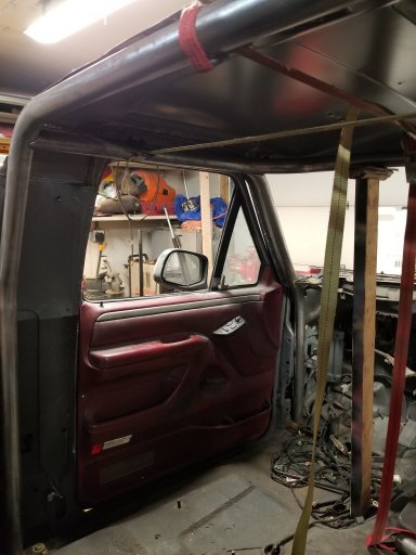

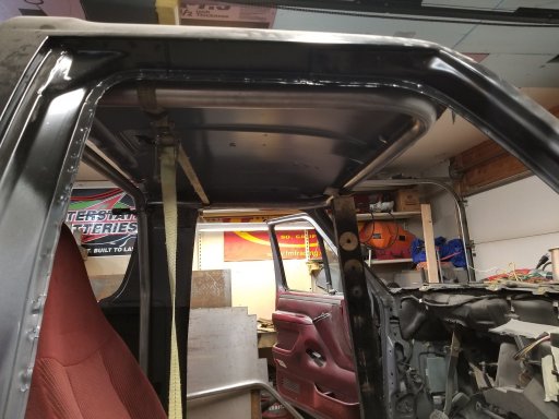

Finally back to it again. We had some water issues. So the house kept me busy for a bit. Got the main hoop of the roll cage bent up.
99345

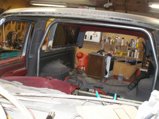

Test fitting the main hoop with the base plates in place. I must have done something right. The fit was nice and snug.
99347
Bolted into place.
99348
99349
Now to start the A pillars. I have the first one pretty close. A little more trimming and possibly adjust the bends. I've just about got it pushed as far forward as I'd like it.
99350

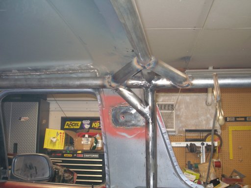

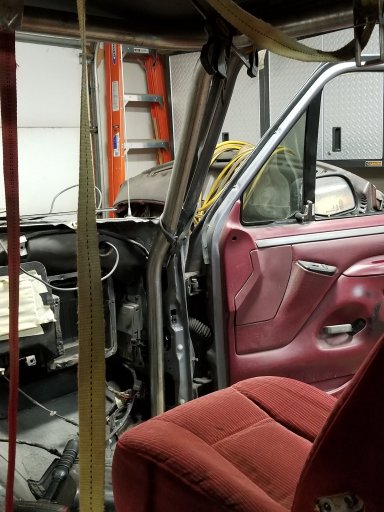

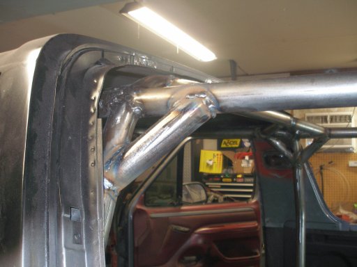

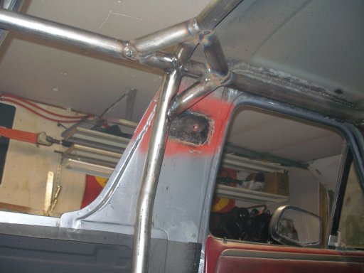

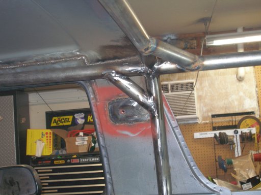

Finally have had some time to get more done. Turns out I didn't like how the front tubes turned out. I don't like how they fit at the A pillar. So I decided to go with a Halo style up front and do the A pillar bars separate.
I'm much happier with the fit doing it this way. I was able to get the A pillar bars where I wanted them.
I Started the gusseting of the corners.

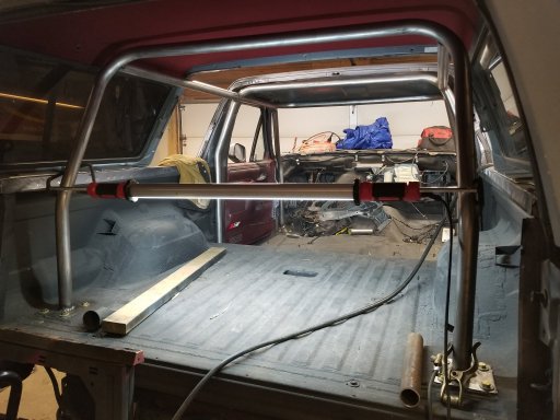

I got the rear hoop in place and the rear bars tacked in.

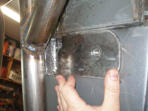

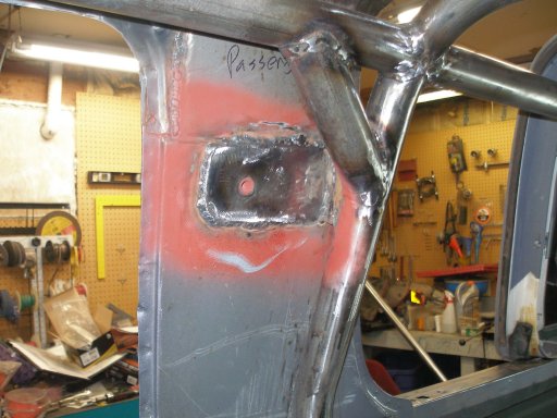

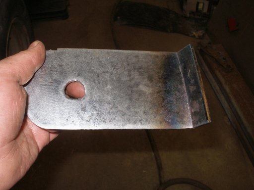

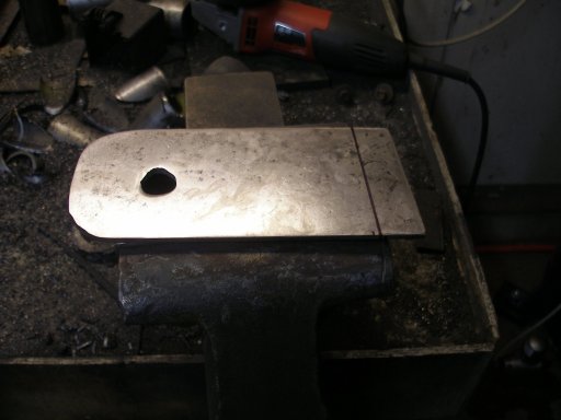

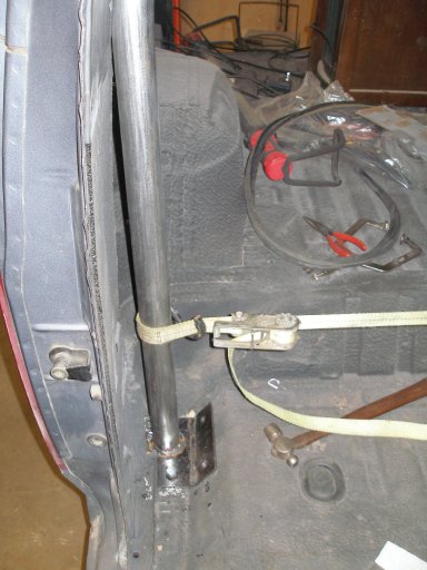

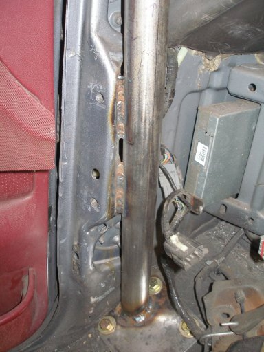

Time to make some seat belt reinforcements that also tie the cage to the body. I made some paper templates and then cut them out of 3/16 plate with the plasma cutter. Marked where I want the bend.
I used a cut off wheel to notch the metal where I wanted to bend it. and bent it in the vice.
Then I welded the edges to make up for what I cut out.
Test fitting.
Drivers side welded in.
Passenger welded in.
A pillar bar welded to the body on drivers side. I recessed it into the body a little for clearance.
Brackets welding in on passenger side.
It's coming along slowly. I'm starting to think I've been overthinking it. But I'm trying to make sure it is strong and yet needs to be usable for everyday family transportation.

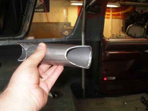

Time to get going on the gussets. Due to the everyday status and hauling kids. I don't have the space to run big x's and cross braces. So I'm going to all a lot of gussets and each corner. I'm also considering plating them to further reinforce it.
To get it to line up on the top bar I had to offset the notches a little.
But I did eventually get the hang of it and managed a decent fit.
Welded in.
And another one in.
And another. It might look a little goofy. But I need strength and room. I don't feel like fishing a kid through a jungle gym and hitting my head every time I need to get them in or out of a car seat.
I'm considering putting another gusset in on the corner of the b pillar tube to strengthen it from the side and give the kids a handle to use to climb in. Not sure though. Probably have to put the seat in and see if it would be a problem.

Time to do the same on the drivers side.
So far I have been able to keep plenty of space and good visibility.
Now I have to do some more body tie in up front and some more gussets and then more of the same in the back. But it's getting closer ish...
