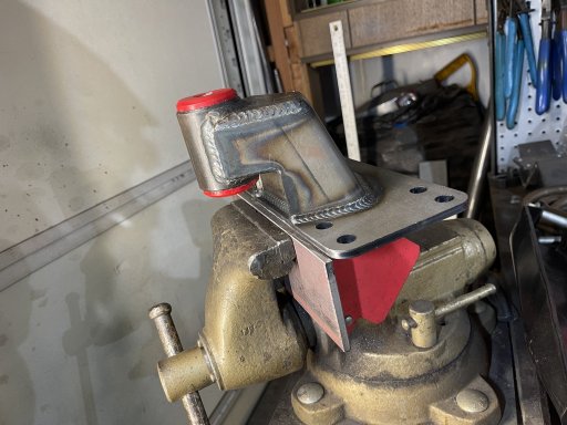

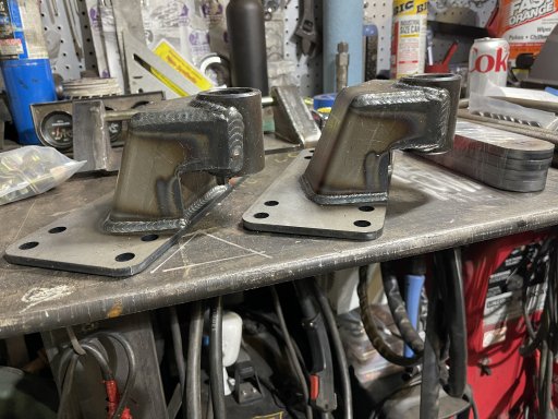

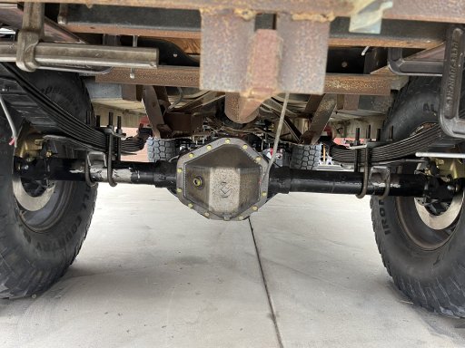

Today I spent an hour or so modifying the rear leaf spring hangers. Still need to go get 10' of 1/4"x6" flat plate to build the outriggers and frame reenforcement plate.
Here is the factory one the it will replace. You will notice that there is a cross member there so it should be pretty strong.

The shackle brackets are made to your dimensions by Ruffstuff. The basic leaf spring brackets are from Barnes4wd.

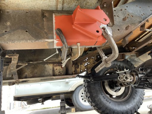

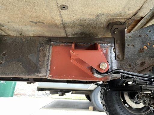

Now to start cutting out the old factory brackets and prepping the frame for the new ones. There are a million factory bolt holes in the frame rails, I mat take the extra time and weld them up, it will look better, just need to get a bronze backing bar to weld against.

They should be more than strong enough. Working this weekend on getting them in.
I welded for a living for a long time as a Pipefitter. But never did much mig welding. I did more X-ray TIG and Stick welding. Just a lot of practice with mig to try to get it to look half decent. And I am not running a pulse mig machine, that would be a game changer.

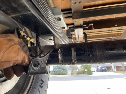

Lots of grinding over the last couple of days getting the old factory brackets removed.
Cut the shock mounts off the axle. Should have done this a long time ago. I thought the u-bolt might sneak by but nope.
Clean metal welds much better!
Double checked the measurements were the same as the other side.
And glued it in!
Need to order some shorter shackles. I have a set of 6" ones but they are way to long. Will try a set of 4". So in the mean time the rear bracket is just clamped until I can set the shackle angles.

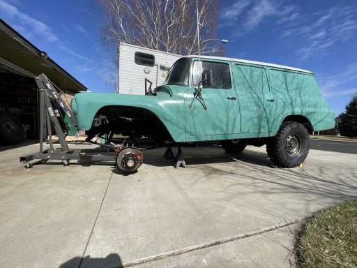

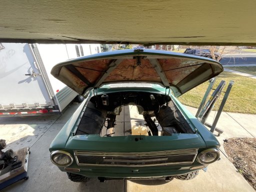

Had the perfect weather over the weekend for pulling the engine. Had to pull the tires to get the front low enough for the oil pan to clear the radiator core support.
A blank canvas!
