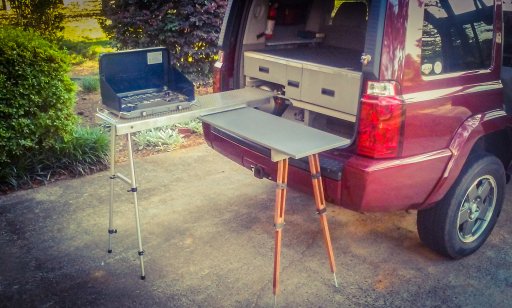

Bought this rig aprox. 6 months ago. It's an 08' Jeep Commander, Sport pkg. 3.7 L V6, full time 4x4 w/ quadra track I.
Have built a custom drawer storage system for the back cargo space. In the process of building a custom cargo rack. Installed a cold air intake filter by AEM. This was done to make room for a second battery system. Built a battery tray so far.View attachment 43302

Sorry for the delay. I've posted an update on the build. Not sure how relative actual measurements would be, unless you also had a Jeep Commander. But all of the drawer system is made of finish grade plywood. 3/8" or 3/4" depending on structural need. Any vertical structural plywood is reinforced with metal. L shaped, flat, etc. I'll gladly answer any other questions you may have.

View attachment 56201 View attachment 56196 View attachment 56197 View attachment 56198 View attachment 56199 View attachment 56200 View attachment 56196 View attachment 56197 View attachment 56198 View attachment 56199 View attachment 56130 View attachment 56131 View attachment 56132 Update on the build: Needed to turn the water tank 90 degrees. It now sits centered L -R and 6" forward of the rear axle. Right where it should be. Of course everything else had to be rearranged. During that progress I added a second table for the stove. She now rides on a OME 2 1/2" HD full suspension. And Hella driving light up top.

The wind deflector was plastic. Nice and rigid, yet flexible. However, the heat was causing it to warp slightly. Still functional, but looked weird. Found a composite aluminum material that will work much better. Very light weight ( lighter than the plastic one even) and will maintain it's rigidity. Also gave me a chance for a redesign. It now covers under the Hella lights. Wind noise from the rack ... Gone now PSX_20180621_081702.jpg !
