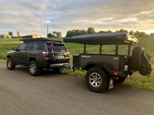

Nice trailer! I have the XV-3 Deluxe Plus which I picked up from Schutt in WI. Do you plan to move the Alu-Cab to the XV-2?

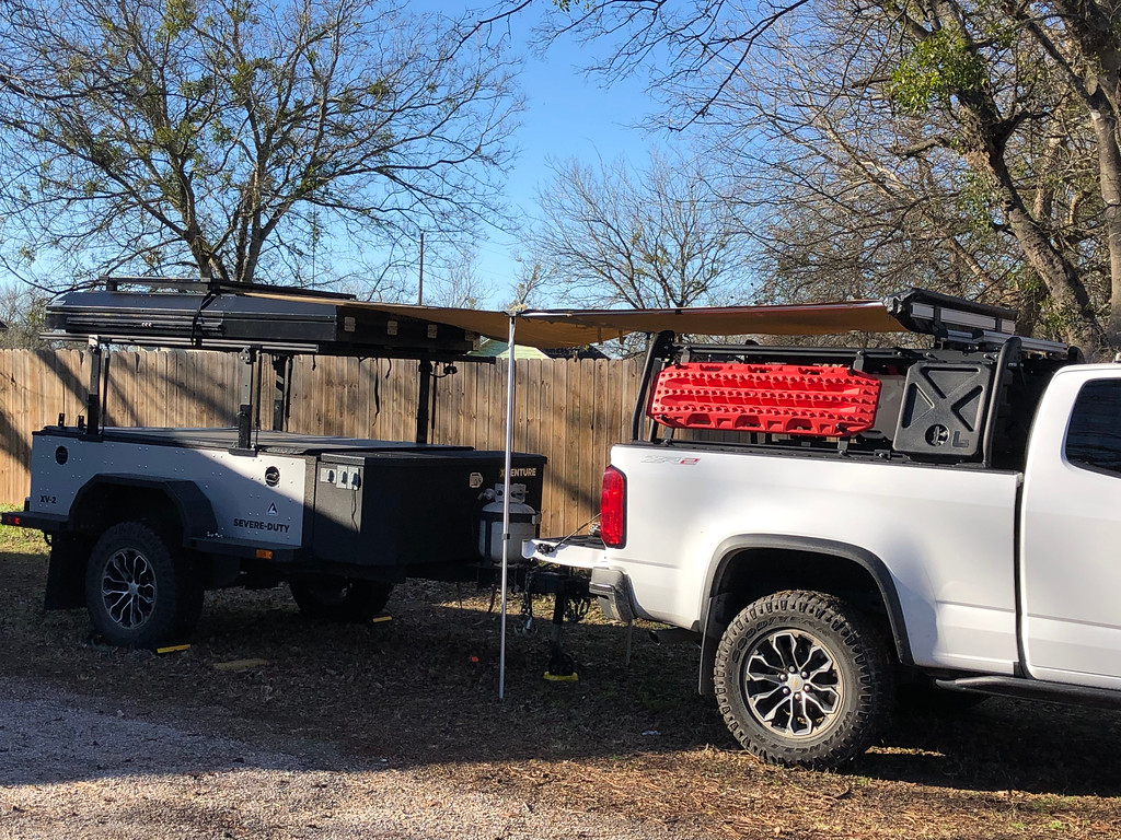

I noticed that my older posts here had broken links to the pictures I posted, so I updated the links and they should all show up now. Noticed also that I haven't updated with some of the changes I made, so even those these pics are older below, might help some folks out.
I purchased some ZR2 rims and got spacers to mount them to the VX-2. Really like the idea of having the same rims and tires that are on the truck as I can swoop out back and forth as needed and means I have 2 spares when pulling the trailer.
Also I purchased a cheap 4 foot wide awning that I mount to the bars of my bed rack to the trailer, this gives cover to the tongue box and the truck bed.
I have since traded my "standard" ZR2 for a Bison ZR2 and moved up to 33" tires and AEV Crestone wheels on the truck, but left the 31" tires and "standard" ZR2 wheels on the XV-2. At least they are the same bolt pattern and can still swoop out between the 2 in an emergency.

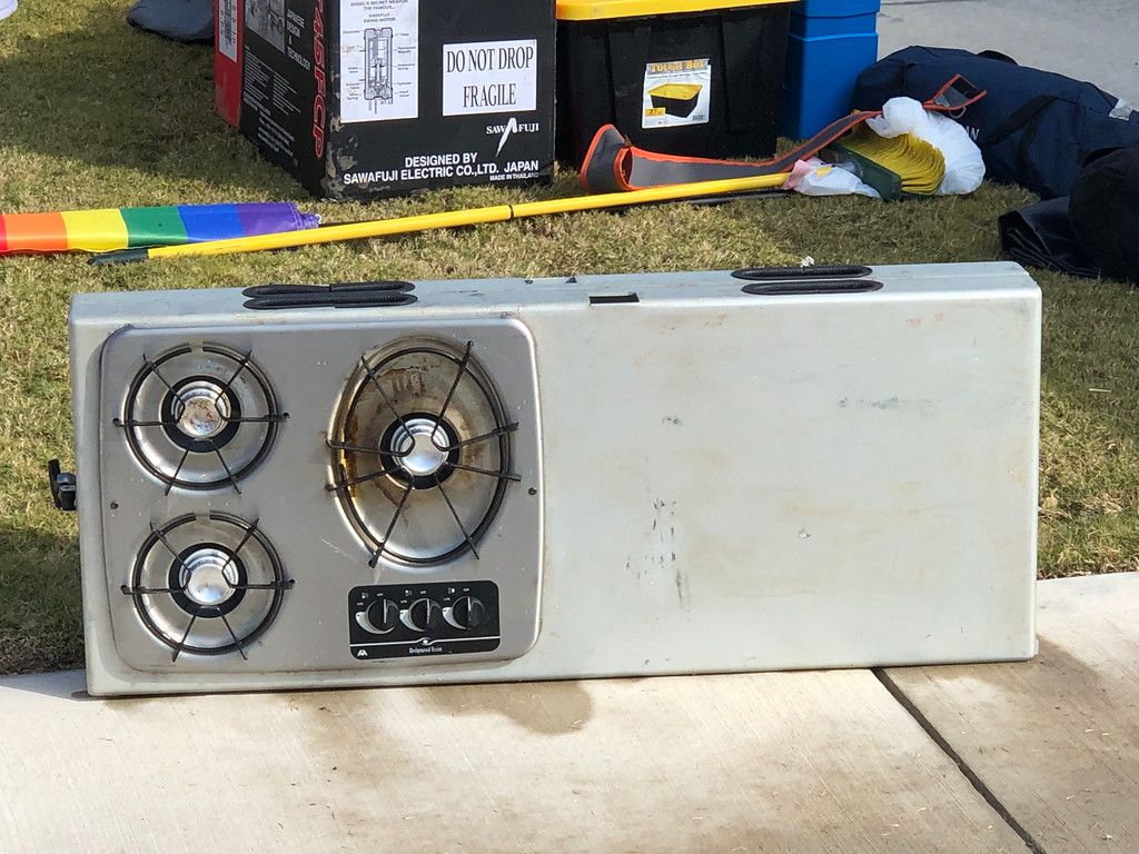

I also removed the stove top that came with the XV-2 and just bought a large poly heat resistant cutting board to cover the hole and place my oven/stove on it.
Here's the iKamper X-Cover on the X-V2, because of the way the X-Cover flips over, I can't center the tent on the 80/20 rack on the trailer.
Cool! Glad to see the images get updated. All I could see here were very foggy images with the photobucket, or whatever it was, logo over them.
Having the same rims and tires on the trailer as the tow vehicle is something I've wanted to do from the start. It's just smart to do and provides redundancy, but was hoping to change the wheels on my van first, so waited.
I opted for the galley table without the stove cutout, because of other users and reviewers commenting that without a solid windscreen, it was not as efficient to use. It's a bulky table for some, but I absolutely love it. Provides a nice long, very solid, counter for cooking, camp chores, and as a workbench. I'm looking at fabricating something, probably one-piece, to utilize the fender holes on the side in the same manner.
