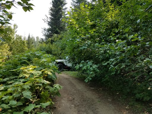

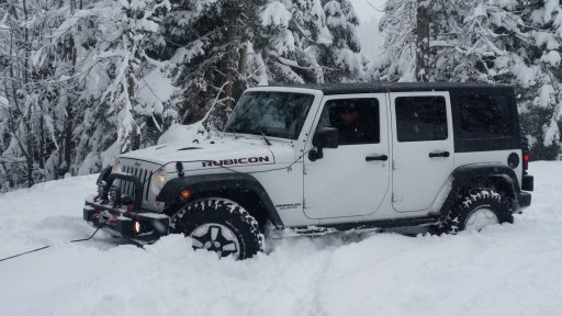

I've got a 76 CJ-7 with a 9000# front mounted winch. I also had a 91 Jeep YJ without a winch. Here's two stories. Both of these I was solo.....
I was driving my CJ into our cabin near Echo Summit after a snow storm. This is an unplowed dirt road, covered in several feet of snow. I was doing fine until I ran into a drifted section and the Jeep bottomed out. No forward or reverse traction. This is with lockers front and rear mind you. I pulled out the winch cable and after pulling from a variety of trees I was able get through the drift and continue on into the cabin. Without the winch I would have been there a LONG time with a shovel.... The trip out I started slipping down hill towards the frozen stream. The road runs along the stream, and in this part there is a pretty steep slope. Out comes the winch again and pulled myself back up onto level ground.
Fast forward to summer time and I was driving the YJ. I had scouted out a river crossing and found the shallowest part. I made it across the river fine, but (previously invisible to me) a submerged tree stump on the opposing embankment stopped my forward progress just as I was starting to climb out of the water. Unfortunately, I was also unable to reverse out of it. Fast moving water and sandy conditions are not favorable to stopped vehicle tires. I broke out the Hi-Lift jack and jumped into the thigh deep snow melt river. After about an hour, and several cycles of jacking up the Jeep, placing rocks under tires, or just pushing the Jeep over off the jack onto a more stable surface, I was able to back out and exit the way I had entered the river. Very wet, and very cold....
Both of these stories ended with my being able to free myself from the predicament and continue on safely. You just have to decide which style of experience you want. Bear in mind, that a front mounted winch works best pulling forward. One on the YJ might not have got me past the submerged tree stump in the river and up the embankment. But we'll never know!

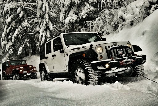

I tend to gravitate towards more difficult trails, and have had a winch on my jeeps for decades. Used every winch to get me out of trouble. One one trip, another rig stripped his spider gears in the rear differential miles in the woods in deep snow in December. I attached my jeep to his jeep and we winched over 100 times over 14 hours to get his rig back to a road on which he could drive. big storm came in two days later and would have buried his jeep for the winter had we not winched him to safety.
If you winch alone and tend to take difficult trails, buy a winch. I spend a week in Moab each year, and every rig has a winch...and we used them every year.winching red jeep up the hill nbr 2.jpg winching red jeep up the hill nbr 2.jpg 20141228_114706.jpg

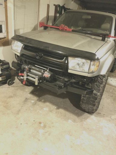

I had kinda forgotten about this thread! I actually built a winching kit for my 60" Hi Lift that can move 30 feet at a time. My original thought was that I could technically winch myself out of most any realistic situation that Id find myself in. I used to wheel in my old Samurai several times a week, and got most all the "hey Skeeter, watch this!" out of my system with that, hah. So, now I dont go out looking for mud or big mounds.
Still, what sold me on the winch was the thought of having to spend 4 or 5 times as long winching in unpleasant conditions. In the worst case, I realized I didnt like the idea of spending an hour hand-winching in wet snow or scorching sun. I will still keep the winching kit around for an additional option to winch backwards or to winch from multiple points (like to apply tension so I dont slide sideways down a hill). But, the Smittybuilt went on yesterday!
I still need to add plates for aesthetics, but the structure of the bunper is complete.

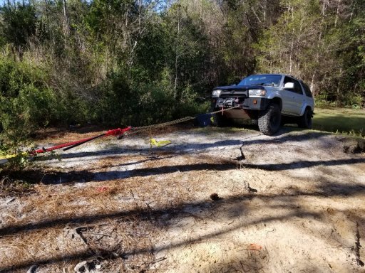

Howdy, friends.
I got a chance to do a basic comparison test between winching with the hi-lift and winching with an actual winch.
Bottom Line Up Front:
Including setup and tear-down, I spent 13 minutes with the hi-lift recovery versus about 4.5-5 minutes with the winch (including partially re-spooling the cable).
I backed my vehicle over the steep side of a creek to simulate being stuck (though, I am honestly not sure Id have been able to climb out on my own with my current open diffs, heh). Then, I winched myself out with my hi-lift, and with a single-line pull from my Smitty.
It took two complete runs of the hi-lift mechanism up the beam to ensure I was fully out of the creek.
Finding 1: The setup and tear-down of the jack winching kit adds about 3 or 4 total minutes to the actual recovery process (removing the jack and chains, assembling the kit, then putting it all back in place), versus about 60-90 seconds to pull out the winch remote and unspool the cable. This does not count setting up the anchor end.
Finding 2: The actual winching process took less than 1 minute for the Smitty, vs about 6 for the hi-lift. This checks with an estimated 12-14 FPM for the winch with a middle-weight load, and about 1.5-2fpm for the hi-lift.
Finding 3: Yes, winching with a hi-lift is pretty hard work! I do have a short piece of 3/8 synthetic winch extension line coming tomorrow so that I could use it with my snatch and the jack. This would theoretically allow me to winch up to 12 ft with half the bodily strain, but would require a good bit of care in rigging to put everything in the right place. Of note, understanding how the jack works, I did not need to be or feel like I was in a position where I could have been hurt by the handle (I find it much easier to get into such a potentially-dangerous position while vertically lifting a vehicle).
Conclusion: Inconclusive, for me at least. For just goin' out a'wheelin', the winch seems to add a lot of convenience when you are deliberately attacking obstacles. However, I will say, all 3 times I have used it in the last couple weeks since the install, (twice to rescue a friend and once to drag a fallen tree off the trail), I could have just as easily, [more] quickly, and safely used my snatch straps and winch extensions. Thus, if one is conservative enough when wheeling to not do hard obstacles alone, then I still think one could get by with a decent set of recovery straps and a hi-lift winching kit.
I guess, really, now owning and having compared the two options, I still wouldnt place the electric winch any higher on my list of priorities. And, honestly, I am still debating whether to keep it on there at all (mostly because the line got a nice kink on the 2nd wrap during its 2nd recovery, which means I need to replace the line).
Also of note, I really wish Id have used 5/16 chain instead of 3/8 chain. It is a joke how much people stress about working load limit on shackles and chains, but then use a 5/16 steel cable with a real WLL of about 2500lbs just because its breaking strength is usually around 10k (and thus technically higher than the winch motor!...). Anyways, 5/16 G70 chain has a WLL of over 4500lb (also the shear bolt strength for the jack...), and a minimum breaking strength of almost 19,000 lbs. So yeah, Id have been totally fine with 5/16 chain, especially since I dont use it for vehicle-to-vehicle recoveries. It would then take up a bit less storage space and weigh 15lbs less than my current 3/8 chain.
Picture is about half way through the hi-lift recovery. Both times, I started with the gas tank skid touching the edge of the bank amd the rear bumper partially submerged.
