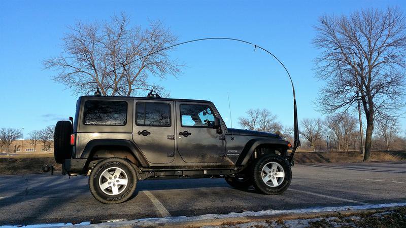

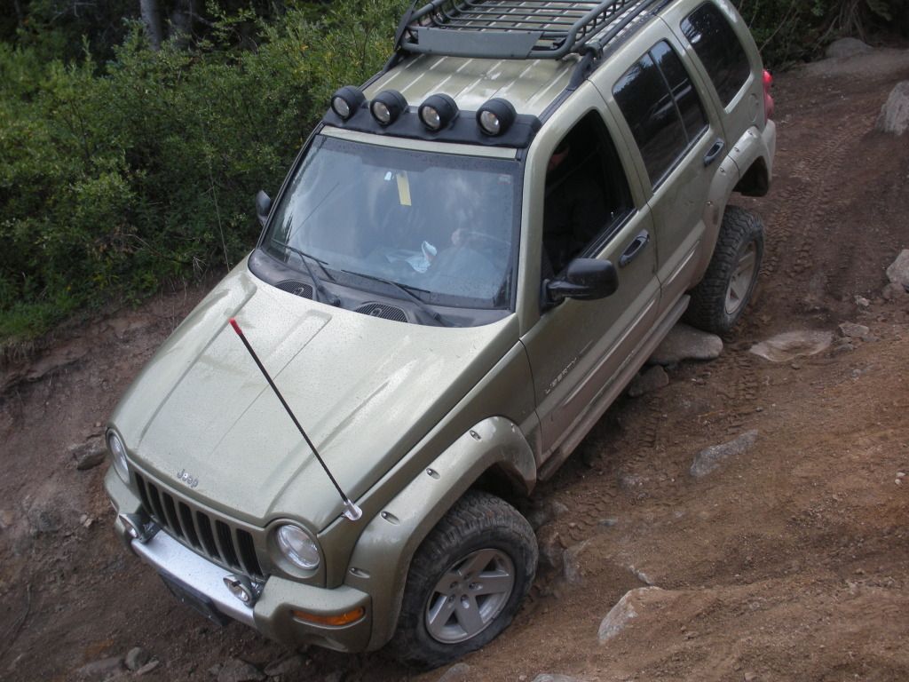

Ham and FRS/GMRS capable. Will probably get a SSB capable CB at some point. For FRS/GMRS i use a Baofeng 82C - The Commercial Version - It has great audio compared to the every store Motorola radios (have used both). Problem i have with FRS/GMRS is Everyone has one and very limited distance of reliable comms, then again everyone has one.
With Ham you have virtually unlimited Frequency availability and a much greater range with the proper antenna - Have heard Mobil Hams talking to Europe on the HF bands. On the trail HAM VHF or UHF bands would be no problem - and if you need more distance you can get 2 meter radios that have up to 75 watts output, though that would be rarely needed.
With CB and the right antenna and good band conditions 5 to a few hundred miles is possible - but not with a Firestick mounted right next to the body of your truck.
Pics are just for example - YMMV.
Popular - but DE-tunes the antenna and limits range:

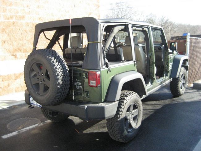

102" whip - Much Better full size antenna for CB and can still be used folded over, but will catch trees:
Best way - With a Firestick type:
And Not obstructed for HF or a 102" whip - and can be folded back while in the woods:
The last one is a high buck Codan Antenna system - But you can do the same with a standard 102" CB whip and remove for city driving.
