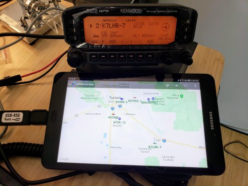

Related: A few days ago I got my tablet all connected to the D710G via USB and decoding APRS packets. Next step is to either hack a bluetooth chip into the radio (more work) or just pick up a USB->BT adapter (easy, but not as slick) so I can avoid running yet another cable across my rig's dashboard
Reactions: TerryD and Dtyo
