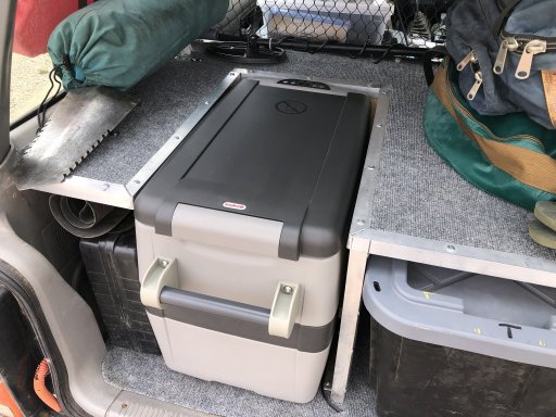

I installed a 700cca side post battery under the rear passenger seat (was). Side post was to keep the top profile low. Ran a piggy back 15a fuse holder off my ignition fuse to a 30amp relay which fed a #10 wire to my "house battery" in the rear. Turn ignition on and the alternator charges the rear, ignition off and it separates.
Installed a TruckFridge TB41A (12v-110v) in the back of the Jeep and fed it with a #12 wire power port.
Just got back from doing Black Bear Pass, Imogene and Mineral Creek, Tomboy Basin Cinnamon Pass and the Apline Loop etc. It worked great with no problems and it was shaken, rattled and beat on by the rocks. Broke a few egges in my plastic container though. Ran it 34 degrees and slightly froze a water bottle. Very happy with it. Cost $549 delivered, no tax or shipping and got it in 3 days.
I ran it for 3 days on the low battery cut off before I went, supposed to have the Dan Foss style compressor. It was very quiet as I slept inside, never woke me up
Side note, I just travel with my dog so I removed the front passenger and both rear seats a created a platform where my dog could stand or lay down. Tools and battery are below along with all the heavy stuff I could fit to keep off the rack.
Fridges are AWESOME!
.View attachment 170795View attachment 170796
