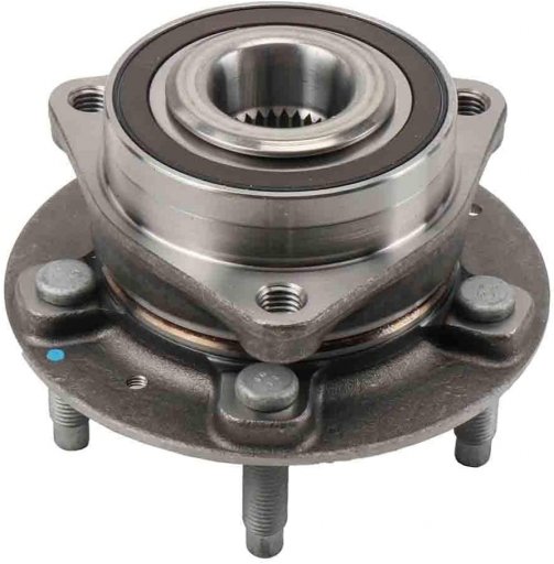

Chevy wheel bearings have been a issue for decades and it's because they hang the wheel on the spindle on a .5" of steel. Pretty telling.
If you add a spacer, you're loading more weight onto the outside of the hub, away from the spindle. Ford uses a inner and outer bearing that distributes the weight along a spindle shaft. (not sure about current models)
I sold hundreds of these hub assemblies over the course of a few decades. It's gonna happen.
I'd also make sure you use aftermarket wheel studs if available.
