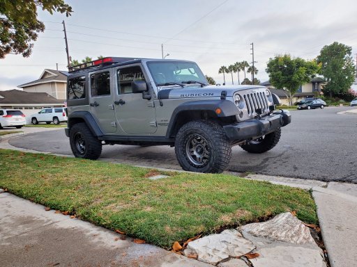

Outdoordog
1,473
Big Bear, CA, USA
Jino
Hwang
21318
I have a 1.5" teraflex st1 lift and fox 2.0 with resevoirs on my '16 rubicon 4 door, 33" tires. It goes to a lot of places that some 4x4s can't. Mostly because of the lockers and sway bar disconnects. Later, I will change the springs to 2.5" and get 35" tires, waiting for the current set to wear down (bfg km3), tread lasts forever and a half with all the offroading I do.
