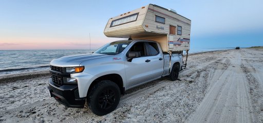

So I bought a new truck, I know, EXCTING!
It's a 2019 silverado trailboss, my plan is to put in a airlift airbags system because I have a slide in camper, but what else should I put in next? I was looking into a winch bumper, but I don't know.

I like those Trail Boss trucks. What any truck should be at minimum in my book. Nice choice! Have a lot of fun with it. Are you out on The Cape in that pic?
What's next? I am guessing a 2500 series Silverado. Those old hard sided slide in campers are heavy enough you are probably very close to gvw in a truck Add your gear and clothes and water, and you could be at or well beyond the weight limit. I'm not saying that as any sort of regulatory body or to be a wet blanket, but to point out it'll make the truck very heavy in the sand, sag in the rear, tougher to handle and wear out parts sooner. The 1500 will struggle with that load whereas the 2500 will haul that camper around all day, every day and ask "please, sir, may I have another?" And it would just about carry the weight of two of those
@Terry Pickens mentions reworked rear leafs. I'm thinking you might go that route with stronger springs and make your half-ton into a modern "heavy half" and you might be OK.
CAN you carry it though? Probably. Check your truck documentation and door stickers. Some of them specifically state not to be used with slide ins.
Best of luck. Maybe I'll bump into you down The Cape
It is a heavy girl, but she's a sunline so it's meant for a 1500. But I just got bags in so those will be installed soon.

If that's a picture on a beach at Cape Cod National Seashore, they do inspections before giving you a sticker that allows you to be out there. I dont see one on this truck but dont know if you've ever been out there in another vehicle, but they have a required equipment list that puts you well on your way, right down to a wood block base for your Jack.
So if you have that inspection and sticker, you are probably fairly well outfitted for what you seem to want to do
I'm out on sandy nexk Beach, so I've got all my stuff too board, jacks, shovel, measuring tape (they have some strange requirements on that list) but like I said, just got bags in, and an onboard compresser so that's my upcoming project. Also a auxbeam control panel for it all. So I've got my work cut out for me
