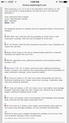

I belong to a local group (ExploringNH.com) and they rate the runs from stock to required equipment. This allows a certain amount of confidence that you will not be "that guy" that slows the group, stops a run or ruins your rig.
Example:
