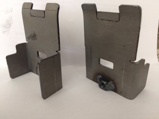

There was a guy on expeditionportal that was making and selling these brackets for Baofeng radios a while back, for installing on your dash or wherever:
No idea if he still is, though if I run across them again I'll try to remember to update this post or add another.
I have the two in this image, and it fits the radio nicely, though have never really used them, or the radios (I have two), antenna, and accessories. To be honest, just never really needed them, as I usually wander solo and have other coms for emergencies.

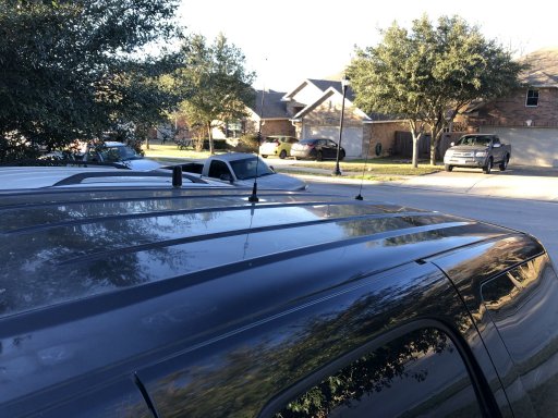

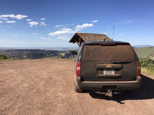

A cable will be anywhere from 12 to 17 feet, and no big deal.
style of antenna will depend where you can mount it and what overhead obstacles you may encounter. I change mine depending on the Trip and terrain.
The center roof antenna in the first pic broke due to parking garages. It was a dual band vhf/uhf piece.
the second pic shows my current setup. The short stubby on the right is also a dual band, and gets used for gmrs as well. The SWR was acceptable for both uses. The center roof antenna is a quarter wave vhf whip. The rear antenna is for 10 meters and can double for cb.
last pic was a road trip to Utah and Wyoming. Wide open terrain and long distances to reach anyone, so the stubby was changed out.
