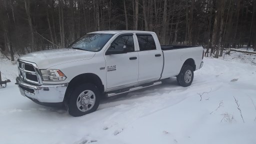

I just bought this a year ago. I paid 19k for it. It is a Tradesman. It doesn't even have satellite radio. Only options are tow mirrors and chrome. Has vinyl seats.
It is exactly what I wanted (other than white) but I had to search hard for it and had to act fast.

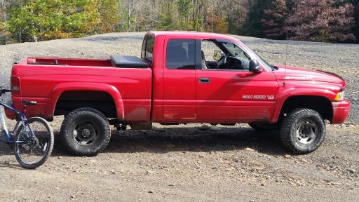

This is my 2nd Gen. You can see the rust has taken its toll. This is a Sport. It is an offroad type package. But it only has an anti-spin (what you are calling a LSD)
