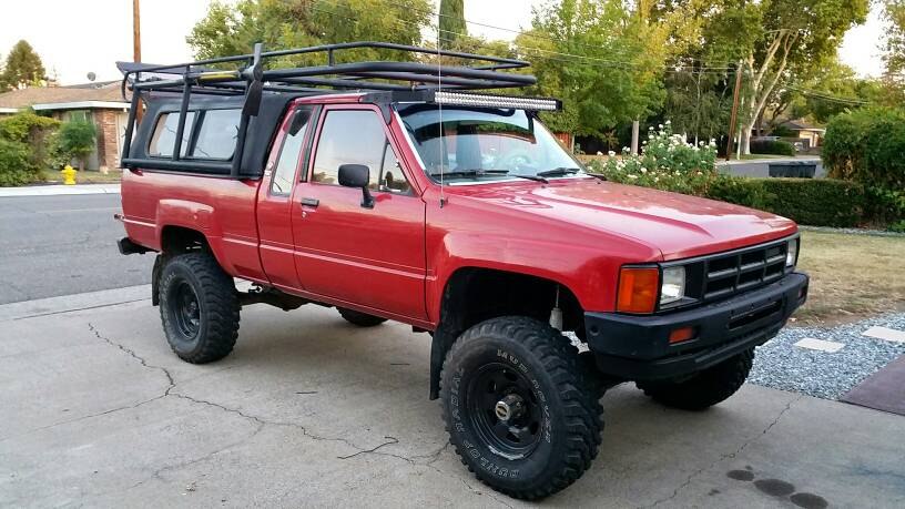

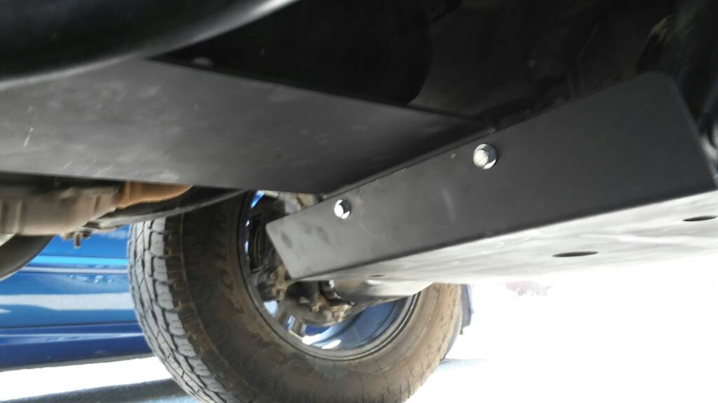

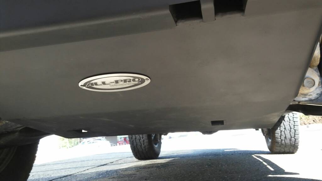

I added Allpro ifs and trans skids![]()

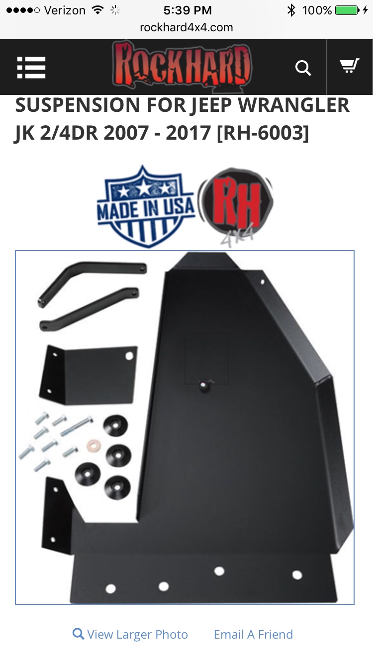

Got you now, and that does make sense. I think if not mistaken I saw that hard rock 4x4 has like a little door on their skid plate to change the oil and trans oil if needed on the Jeeps. I think that's a pretty sweet idea.Haha, no worries @Jose!

Wonder how well that would hold up to abuse??Got you now, and that does make sense. I think if not mistaken I saw that hard rock 4x4 has like a little door on their skid plate to frail the oil and trans oil if needed on the Jeeps. I think that's a pretty sweet idea.
Don't know if you'll be able to see it but this is the one they make for the JKU it's in the middle and flush. They also sell replacements just incase it does get messed up.Wonder how well that would hold up to abuse??

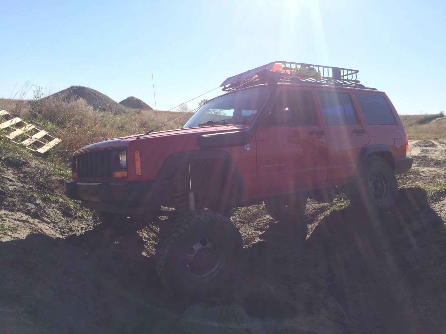

I'd call that productive!I didn't do anything productive. Flex test after control arm drop bracket install.
I saw your truck on califabs instagram lol
