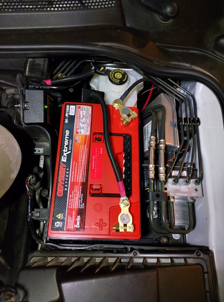

Dual battery project is pretty much done. Still need to get a better battery tie down for the aux battery, the OEM one is not a great fit.
The LR4 starts SOOO much easier now. I think the stock battery is crap. The new starter battery is a larger size and a good AGM. The aux battery is an Odyssey AGM, and is high quality. Together, I should be able to run a lot of gear and fridge for days and never have to worry about the starter battery due to the isolators.
The factory water proofing/covers still fit, but this is just a picture with those removed. The battery boxes are sealed up pretty good from water.

Outstanding. I'm sorry if I missed it but what type of Battery controler are you using @mbwesner ?

The kit I got was Traxide D3-BS which is the SC80-LR isolator for protecting the cranking battery and the ABG-25 isolator, a low voltage cut-out, for protecting the auxiliary battery from being accidentally over discharged.
http://www.traxide.com.au/complete-diy-dual-battery/land-rover-dbs-kits/discovery-3-dbs-kits/d3-bs--sc80--abg-25.html
The SC80-LR is a version of the new SC80-CB with an external breaker for easier install. http://www.traxide.com.au/isolators/sc80---90-amps-standard.html
It supports some nice features. It is not a DC to DC charger. Both batteries can be used for accessories until the cranking batt is isolated (At 12v, 50% left, plenty for starting the vehicle). Both batteries charge in parallel via the alternator. The Aux battery can even charge the starter batt via reverse charging. It also supports solar very well.

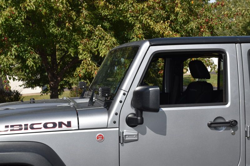

Finally got around to installing my sPod and the Rigid D2 Duallys I had from my old build. Mounted them on the a-pillar this time around. The sPod instructions aren't great which made it irritating to install. It's tough to see in the pictures but the switches light up red.
