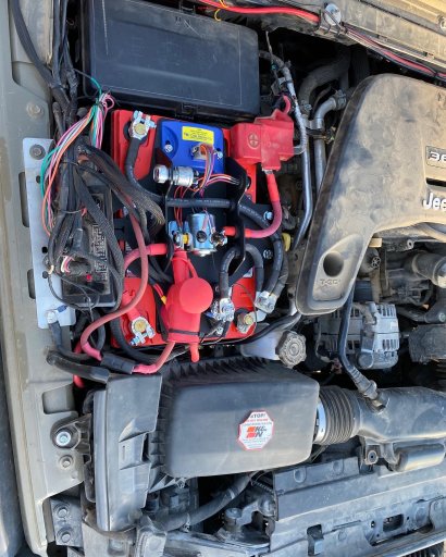

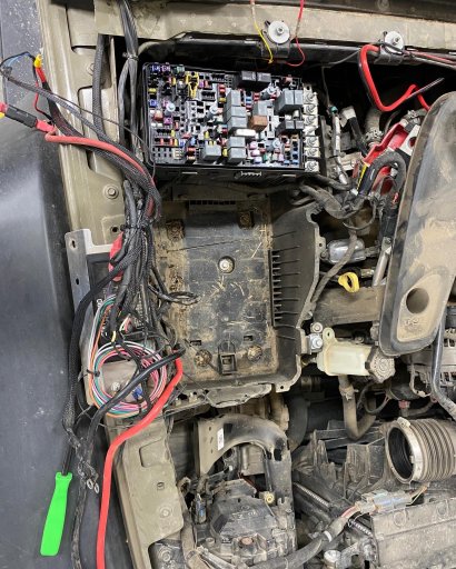

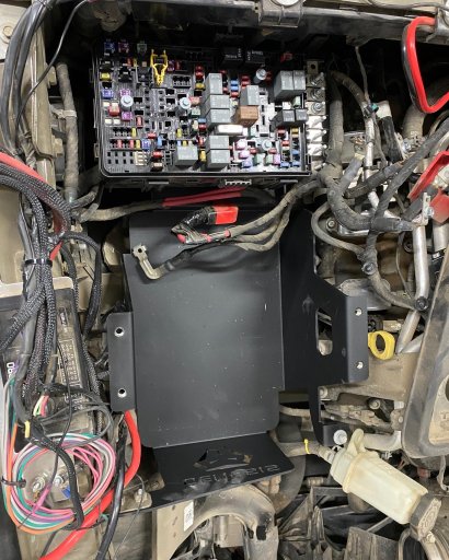

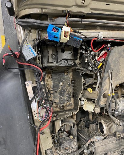

how the heck did you fit that in...photos?
Genesis duel battery, only way to go mainly because it eliminates the aux battery from the factor that causes so much trouble. It is way easier than it looks to do this only about 2-3 hrs of time.

Nice job Kent...obviously you're a professional. I'm opting for a battery switch...had to yank the battery out and hook it up to my solar charge controller more than once ;)

I think this is a super good upgrade for the Jeep. Because I have heared from so many that they have trouble with the weird aux battery construction that is installed there originally.

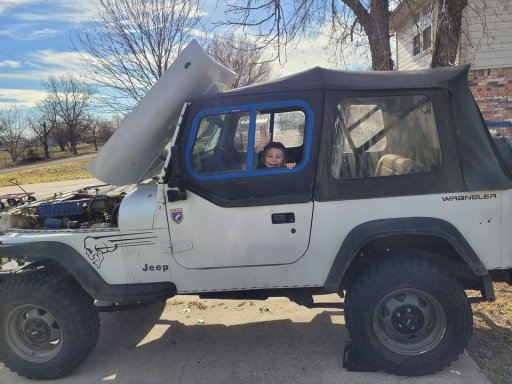

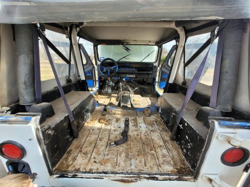

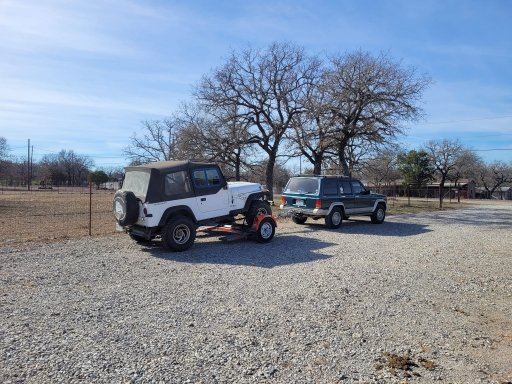

31s swapped for 235s
Frame welded redneck bumper/winch plate cut off and tossed
2 inch body lift deleted.
Radiator drop kit deleted.
Wanted to make more progress but one of the body mount bolts fought me and I had to cut an access for one of the square nuts under the passenger seat.
Also picked up a bunch of parts today.

Looks like a lot of work!

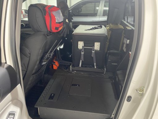

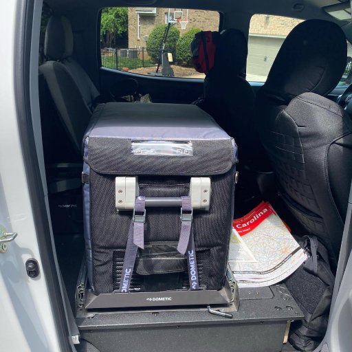

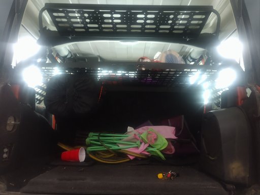

I had previously installed the 60 percent rear seat delete and it provided a great place to keep the fridge safe.
I finally got a around to installing a 40 percent delete and now have plenty of room for activities!
The only thing I'm jealous of with Jeep and Toyota owners is just how much stuff is available to you guys. I have to get pretty creative with my solutions (not that I mind that), but that is a very clean install.

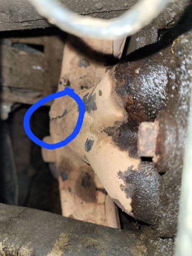

Got the YJ restarted today. New battery cables, battery, serpentine belt, idler pulley bearing, plugs, wires, cap rotor, and valve cover gasket. Starts better but still idles rough.
Found a sizeable crack in the exhaust manifold, and fuel pressure is sitting at 20 psi. It should be 31 at idle, or 39 if you unhook the FPR. Unhooking the FPR made no difference. So will be ordering a new manifold this payday and troubleshooting the fuel pressure issue.
Theres also a constant rattle that MAY be the timing chain hitting the cover. Or the second idler pulley bearing, stethoscope shows the noise in both areas but they're really close together. Ive got a spare idler pulley bearing so Ill try that first before replacing the timing chain.

Bummer either way. Hopefully it's the lesser of the evils...
