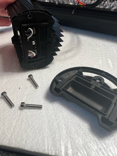

**Edit** - I don’t know if it’s the app or what but these pictures did not upload in the order that I selected.
All right. So I gambled on Auxbeam pods and a small 20” bar. After reading as many reviews as I had the patience for, I decided to go ahead with it. I think the number one complaint was condensation.
So in an attempt to get ahead of the potential problem, I thought I’d seal them up. This can obviously apply to any cheap lights given you can take it apart (at least the ends). Auxbeam claims IP68 buttttt …right.
If anyone wants to try this …I would’ve rather used black silicone but I had a tube of clear. Just take the ends off and rub it in over the existing, supposedly water tight, gasket. I closely examined anywhere that water could creep in and just, for lack of better terms AND skill, lathered it on. But not too much to where it would overspill when tightening the cover back on.

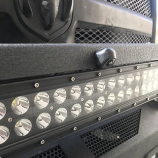

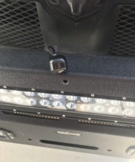

brakes, tire rotation and oil change. Started installing my break over camera. Added some tie down point to the roof rack.
View attachment 226072View attachment 226073View attachment 226076
For any Ram owners out there here’s the threads I’m following to install my camera. Cargo cam to front cam hack, Cargo cam 2
