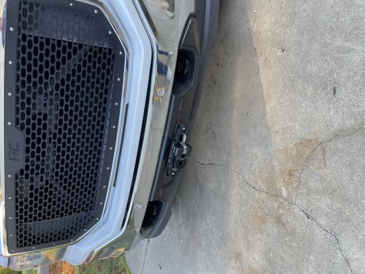

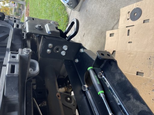

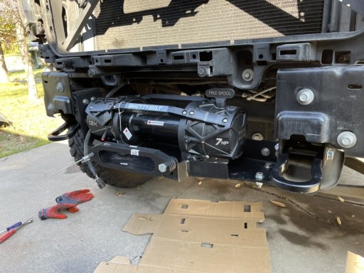

I put a new winch on my Sierra. I waited for a while for the RC hidden winch and they finally came out (about a year ago). Very well built and not too bad to install. There is some cutting and drilling to do but it can be done with a cutoff wheel if that’s all you have access to. I’m very pleased with the outcome. One other note is that the supplied bolts for the fair lead is not long enough. You’ll need M12x1.75x80 to bolt it on. Fun to find 9EA8D261-571F-470F-81A1-681B67C69180.jpeg7D7D496F-D794-447F-AE15-B1D8793543A0.jpeg out on the last step.12EA5887-7863-4F71-9B0E-B6C1F51BFA38.jpeg
