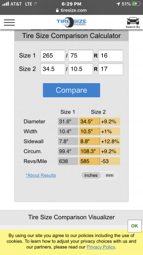

Thanks for the info. The difference is 1.5" but it's the gear change that I wouldn't want. The 35" is 5" larger in diameter than a stock (29.5") LRD2 tire size. That's a huge change for a factory 370 to 1 diff gearing (might get better gas mileage though).. Anyway I just bought new tires and need to see how they perform before I would do any tire size change.

Well technically it’s only 4” bigger due to 35s not being 35” and your only dealing with half of the tire so your really only adding 2” of added strain on the drivetrain

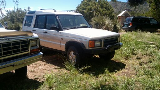

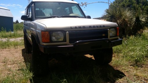

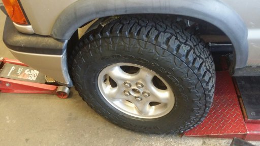

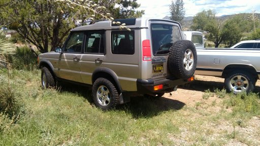

A stock LRD2 tire is 29.5". The 35's are 34.4". That's a difference of 4.9" technically. Or 2.45" taller tire. Do you have a Disco ? The first pic is my LRD2 with the 2" lift and 32" tires and just added new rear bumper. I have to air down to get my spare tire on now. A conversion tire carrier can be had for the rip off price of over $100 bucks.. The second pic is my LRD2 with new 32" tires and new front bumper and 2" lift. The third pic is my LRD2 with stock bumper, no lift and showing the bad fitment of 32" tires on the stock LRD2. The fourth pic is the LRD2 front bumper with raised light bar for the yet to be installed 9" LED driving lights. I'm almost good to go on it's first adventure as soon as I'm well enough to handle a solo run.
