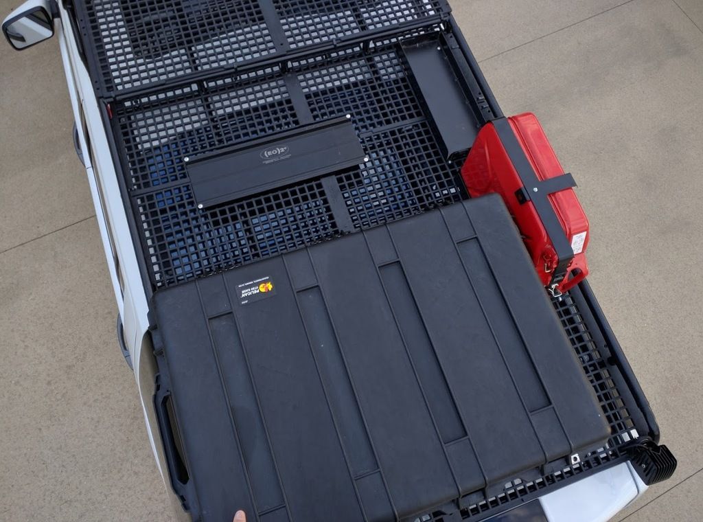

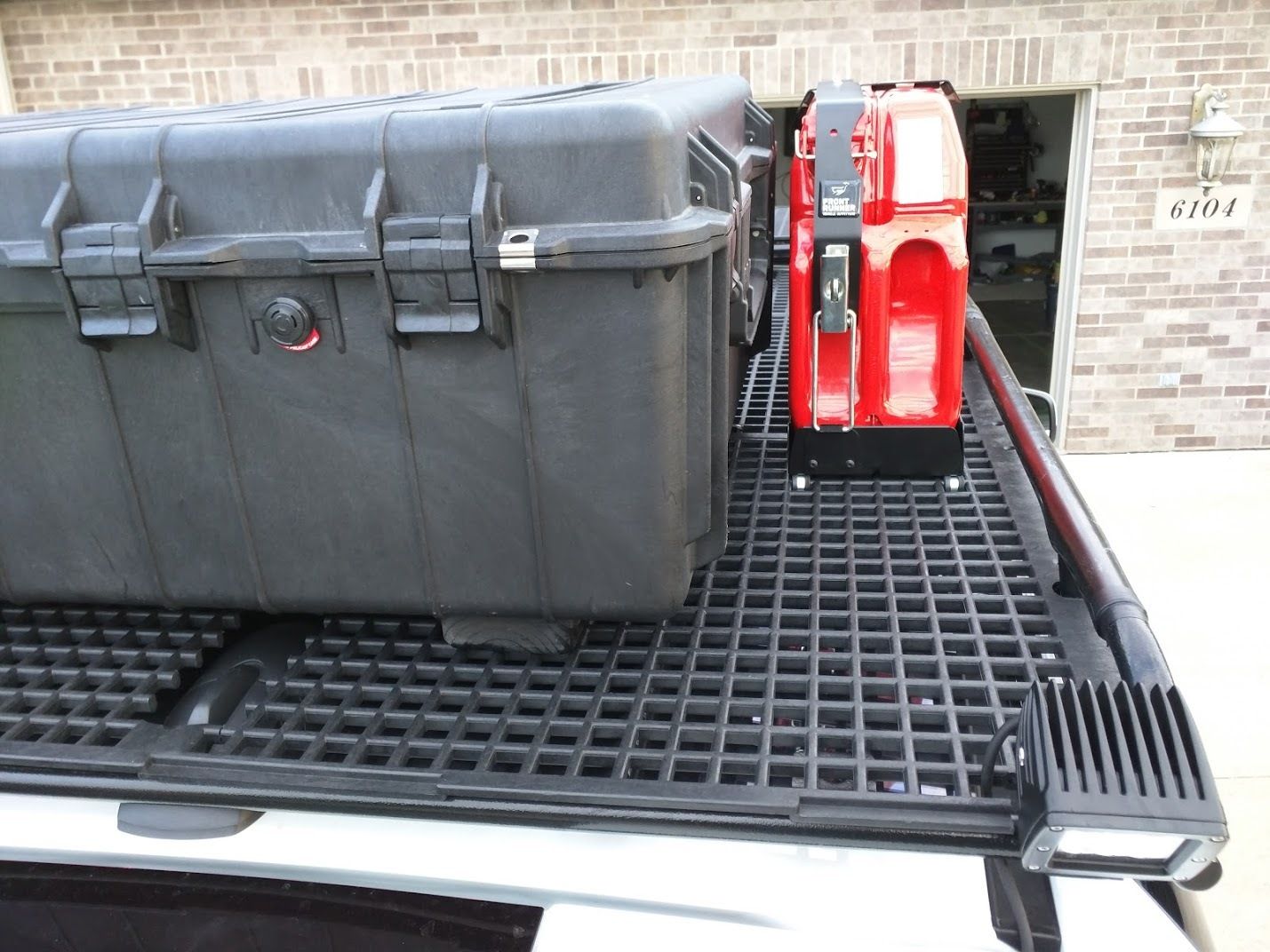

Finishing up my latest rack project. Now I can put two 1730 Transport Pelicans on my EO2 mounts and have two jerry cans mounted.
Now since that little spot next to the cases was where my tent pole bag went, I need to fashion some mount off the side of the rack with super quick fist clamps.
The spacing is pretty good. Height matches the pelican cases.
Also wanted to show that a Front Runner Stainless Steel prep table fits PERFECTLY.. like, to the millimeter, on the rear shelf across the cargo area.
What roof rack is that?

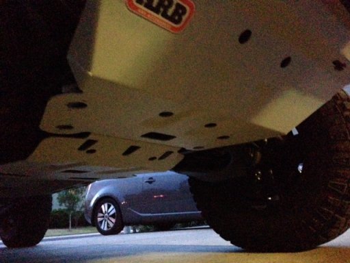

New skids, I really like how they fit. Nicely engineered and only 20lbs more than the stock tin.....
ARB those from down under do some great work.....

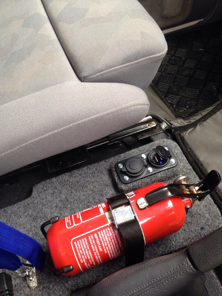

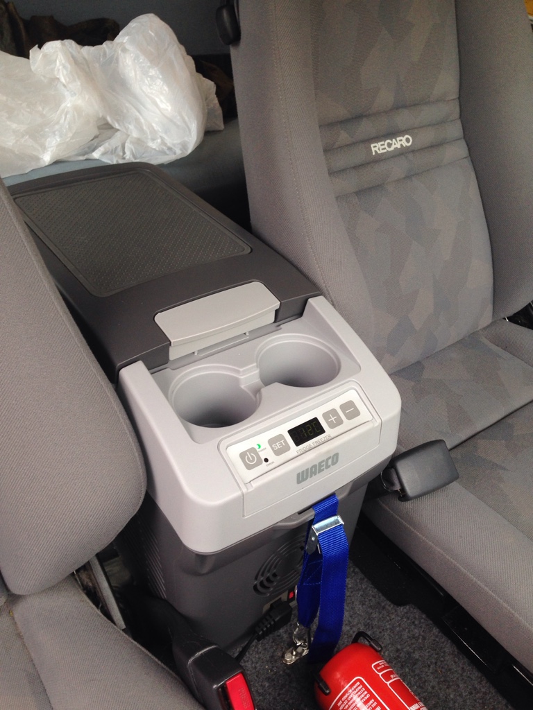

Wasn't today but only just got around to posting from this weekend. Finally fitted a small fridge between the front seats so no longer have to open the main fridge for drinks and snacks on the trail. Plus I get cup holders - luxury [emoji41]
Also added a mount for the fire extinguisher and some much need usb sockets for power

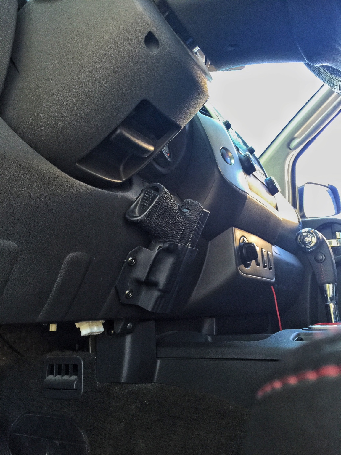

Did you just drill it into the plastic? I have been wanting to get something like that for a while now[/QUOTE said:
So I measured it out while still intact, I looked for two things when deciding where I should place the holster....
1. Out of the way from keys hanging down and knees while driving
2. Ability to have a solid purchase on the firearm while deploying.
After I found the spot i wanted to mount, I removed the lower plastic piece drilled my holes, used spacers to allow the firearm to fit in holster when pressed up against lower dash and then mounted the kydex and snapped the lower plastics back on!
All in all only took about 10-15min.
