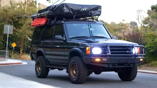

255-70/16 in an 8” wide and +8 rims. It was only on off camber but noticeable enough

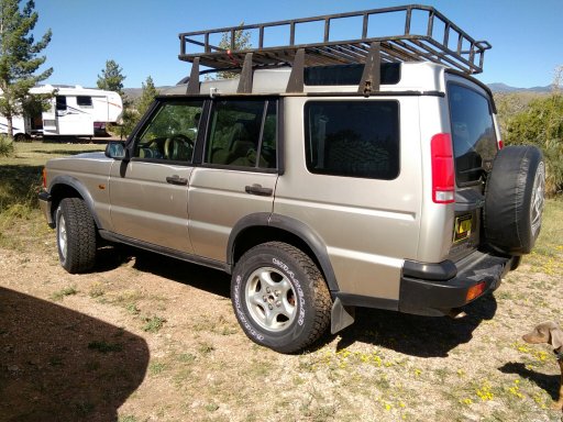

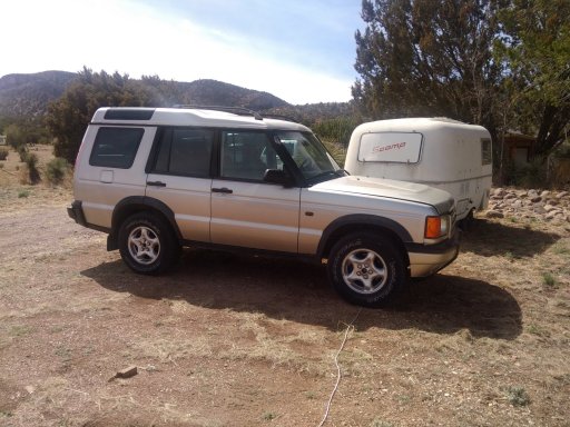

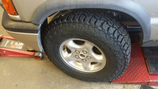

That's weird. I had 255/ 70r/16 on my rig with no lift and never had any rub issues. I added the 2" lift spacers and 1" wheel spacers in anticipation of buying a new set of tires in size 265/75R/16. The new tires fit but touch the front bottom of the fender bumper valence. I will trim off about 6" and it will be okay. I'm planning to put a new off road bumper before to long anyway. I didn't change wheels because the stock wheels are wide enough as is. I like your wheels but not the price and if your wheel rubbed it was because the back side offset was wrong on your new wheels. You sucked your in with offset and added a litytle width, where I pushed mine out 1" with a spacer and stayed with stock wheels. See pictures attached. First pic = stock with 255/70r/16. Second pic = 255/70r/16 with 2" lift. Third pic = close up of 2" lift and 265/75R/16 tire, 31.7 " tall. The 265/75r in this brand tire has a 10.9 " tread width that is about an inch wider than most 265 tires. Pay no attention to my roof rack. It's just up there in order to take it to the welding shop for some new brackets and a good clean up and paint. I bought this rack from a man who had it made in Africa for his LRD2 a few years ago when he was on a hunting safari there as a Diplomat for the USA. The rack was built to carry 1000 #'s.
