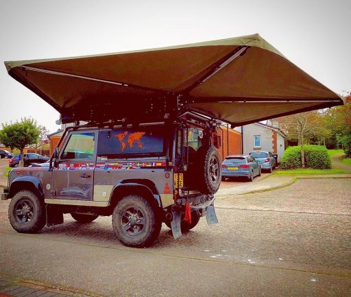

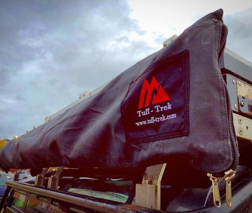

Awesome looking rig!Constructive day today, fitted the new free standing Tuff Trek 270 degree awning.
Once it has the sides on and the frontier stove flashed up it should be toasty for winter.

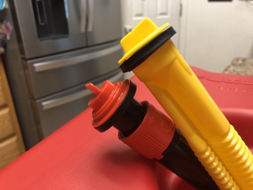

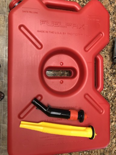

I figure they are worth a try. The RotoPax branded ones are like $12.90 each. I got a knock off brand 3 for $18.50 and I have two FuelPax.Those look like the same.ones scepter uses on their light blue 5 gallon water cans.
