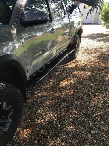

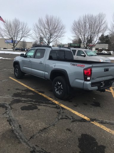

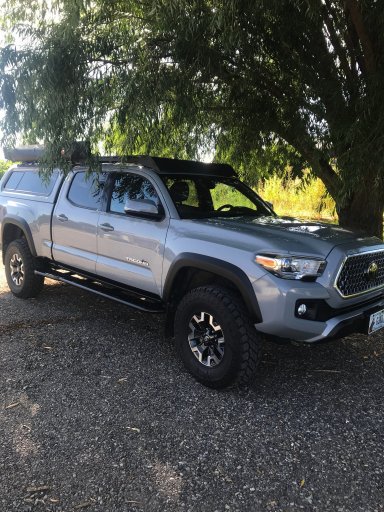

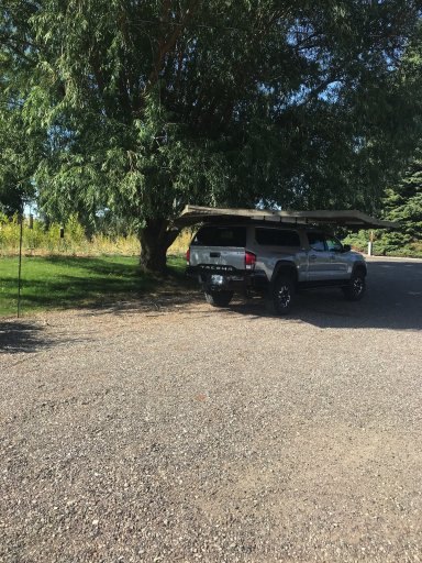

Not on a weekend but over the last 6 months. Rear shell, bed rug, Prinsu racks, CBI rock sliders, Nitro 4:88 gears, 23 Zero Peregine awning and finally the MLO suspension to carry all the extra. I very pleased with "little one" now. Next year I'll add skid plates and a 12V system to the bed.

actually the 4:88 gears solve a problem the 3rd gen Tacomas have. the 6 speed is a double overdrive and the tranny is constantly hunting gears and over reving. I'm running a 255/85R16(33's) and at 80MPH the RPMs are 2400. My mileage actually went up with the swap. / Its 4WD. and the gear is because I want it and to be comfortable camping the way we like. I can carry my Flycraft boat to more places with the rack .Not sure why you ask about locking? the shell has a lock, the rest bolts on and lastly i live in rural Idaho we don't have to worry to much about thieves out here. If you get caught stealing you usually get shot. Great deterent

A lot of people are recommending 5:29 gears in the new Tacos. and its working especially with bigger tires. I went with the 4:88s because of the 80 MPH freeway speeds out here
