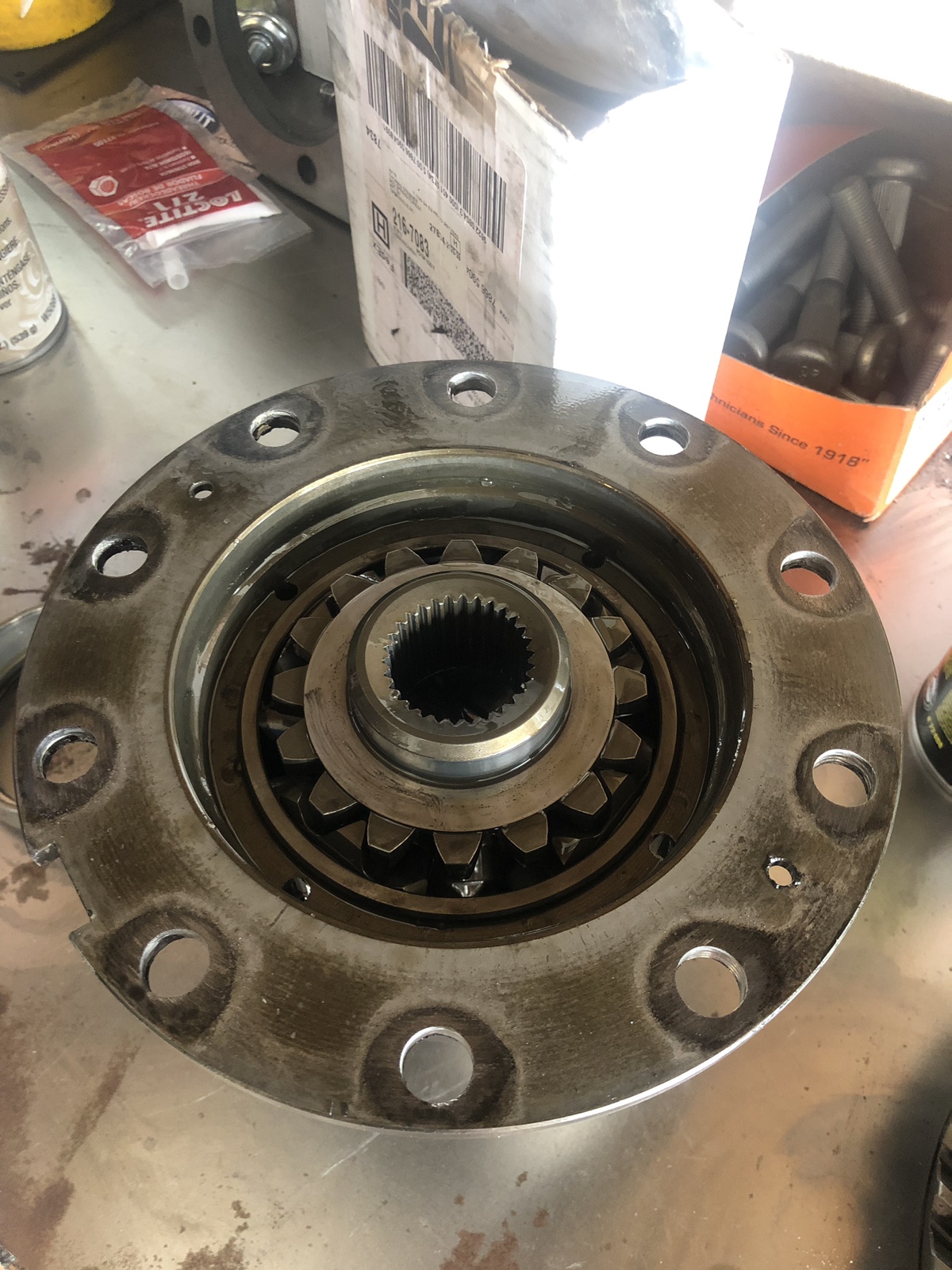

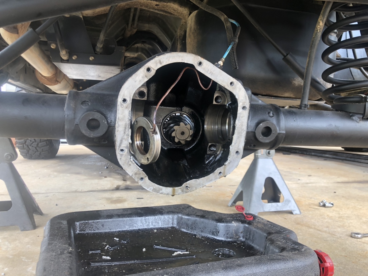

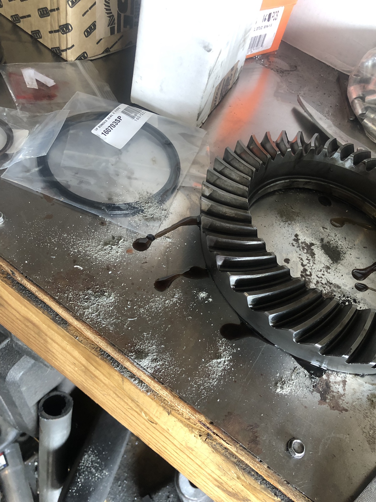

Tore apart the rear axle today to find and fix the ARB locker. This is the 4th or 5th time I’ve had the axle apart in about as many months. Leak was coming from inside the locker this time so took out the carrier, tore the locker all apart and cleaned everything to be brand new looking. Replaced the ring gear bolts because there was sand all in the threads, replaced the seal housing o rings and the bonded seal. All is good now finally.
The front will be tackled next weekend. Front has bigger issues. Copper line got blown into the diff and ring gear caught it and shredded it and broke the seal housing. Some pics from this weekend.

By no means am I a pro. I was working with a buddy of mine who has never done this before either. It’s really not difficult. We found the exploded view of the locker and just started unbolting things until it was just the cage and all the teeth were out. Thank you for the compliment! We will be doing the front one next weekend

The bulkhead fitting is what failed and let water in. It’s not a bad job, just time consuming. Having selectable lockers is great especially when you need traction immediately

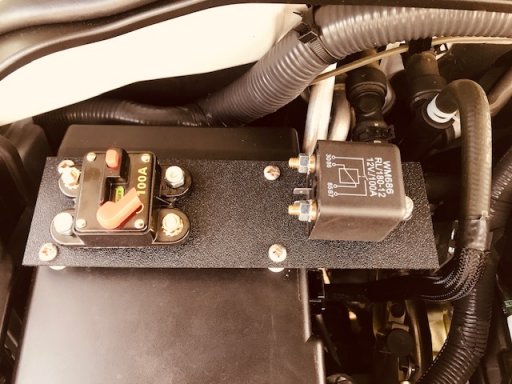

It drizzled on and off most of the day yesterday. Although it didn't hamper my wiring project too much.
After lunch, while my 6-pack of beer was chilling in the shop fridge, I began to make up and solder the wiring connections. I installed the power wires from the battery to the 100 amp breaker, then to the 100 amp relay, then to the fuse/relay board inside the truck. I was going to run the relay energizing wiring, but I found that I was short on 12 ga. wire. I'll pick up a couple rolls of RED and BLACK 12 ga. today. Of course, the weather guessers are calling for a flash-flood watch this morning, and rain for the next few day. So I have no idea how much I'll be able to get done.
BEFORE:
AFTER:
That's about it.

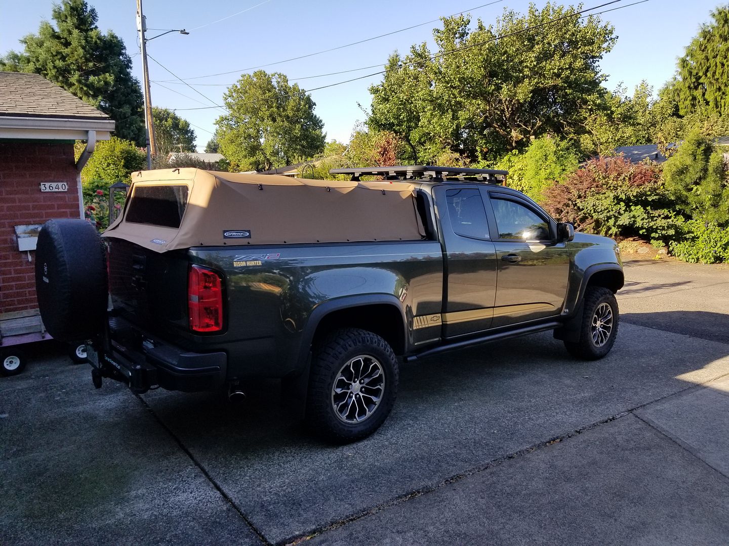

Changed from a tri fold cover to a softopper, should be a step up from the bed tent I have been using. Ordered a Slumberjack Roadhouse tarp for more covered space. I never spend more than one night in the same location, I think this is going to be quick and easy setup. Slumberjack has a 25% laborday sale going.
