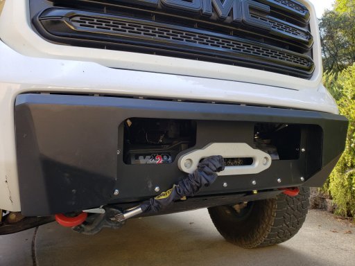

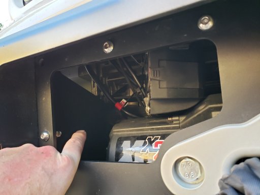

I got my winch wired up this evening after work. It's operational now but I need to make a mounting bracket to hold the control box. I found a nice spot for it that will keep the wireless on/off switch and the connection for the wired input up front and easy to access. I was worked after connecting the wires to the back of the winch without removing the winch from the cradle so I had to call it a day. Zip ties will hold the controller for now. lol
I'll make a bracket and mount the controller box right here.

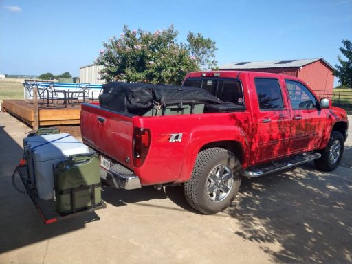

I would consider running a stap over the cans as well unless they fit very snug in the holders. I noticed mine rocks around in the holder when driving rough roads so I now secure it with bungee to reduce wear and tear as well as stop noise. Mine is mounted in the bed but hitch mounted platforms have even more movement. Looks good!
I just got a jerry can and was looking at the smitty built holders online...are they pretty well built? they cost over half what the can cost, but it seems to be the best way to mount
$30 on Amazon. They are well built and have an adjustable strap to fit short, as well as tall, cans.
My cans fit well. Snug enough to need to push them in, but not too tight that they scrape. Drove them to/from work this week and they did not move or rattle. We'll see about rough roads. The holders come with rubber isolaters, which are not the best, but do well enough. Everyone recommends (me included) to glue them in place as soon as you get them as they tend to fall off otherwise.

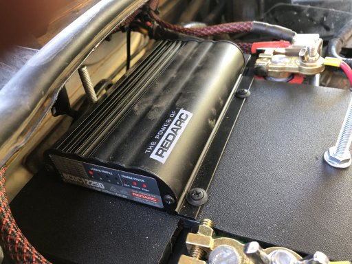

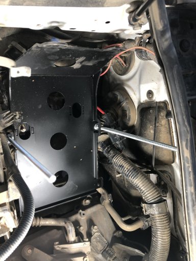

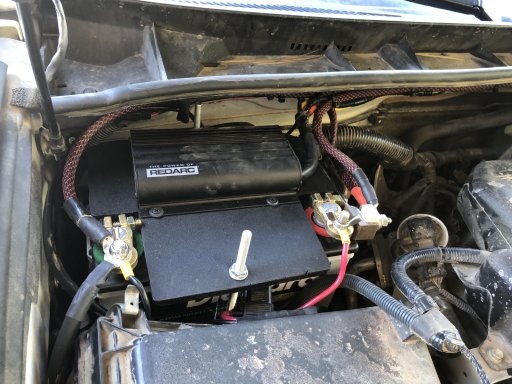

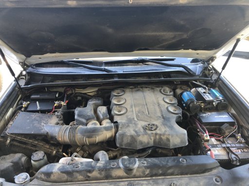

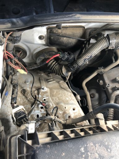

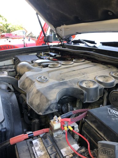

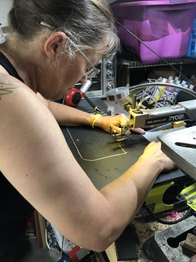

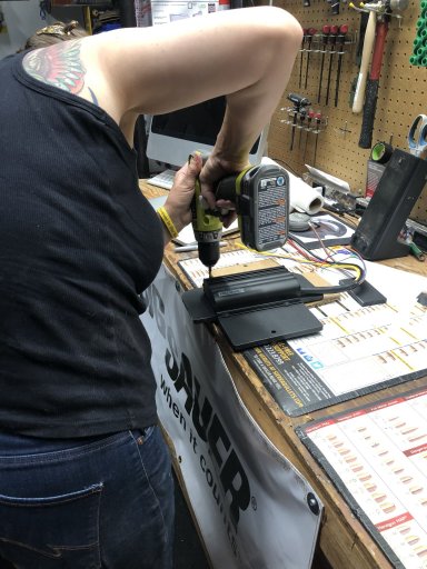

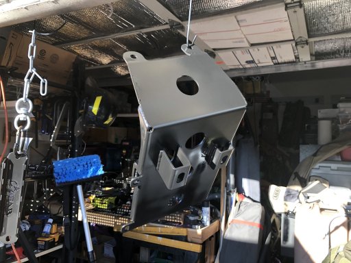

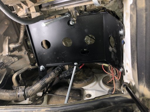

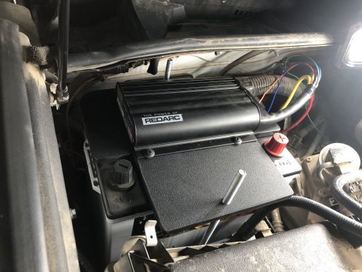

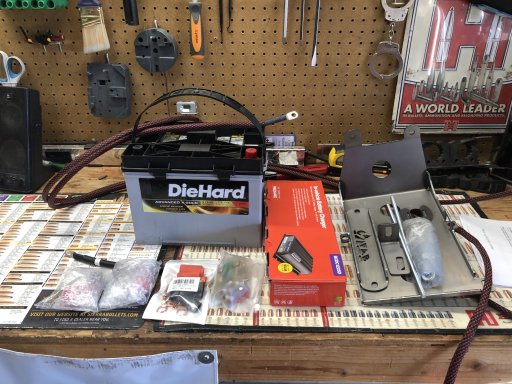

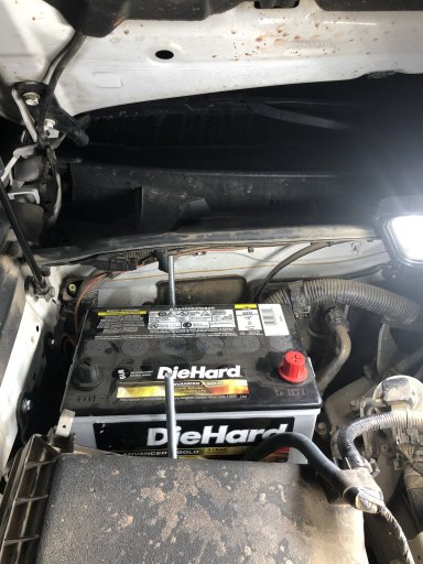

Well this happened. @Firemom and I installed our dual battery system and Redarc BCDC 1225D DCDC to DC charger yesterday. Fairly easy install, had to make our own mount for the Redarc charger. Used a C4 Fabrication dual battery tray and got the battery at Sears, but everything else was picked up on Amazon. Built the entire set-up for under $900.00IMG_1401.jpgIMG_1406.jpgIMG_1409.jpgIMG_1414.jpgIMG_1416.jpgIMG_1406.jpgIMG_1409.jpgIMG_1410.jpgIMG_1411.jpgIMG_1412.jpg
