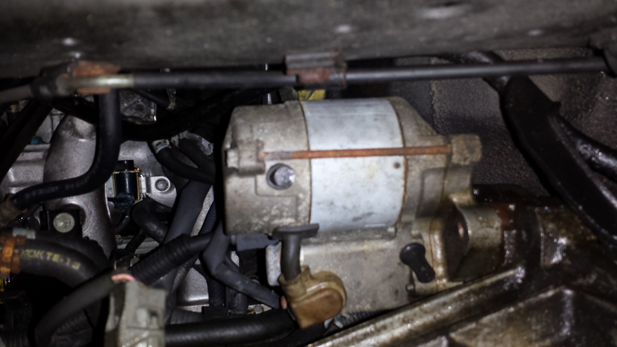

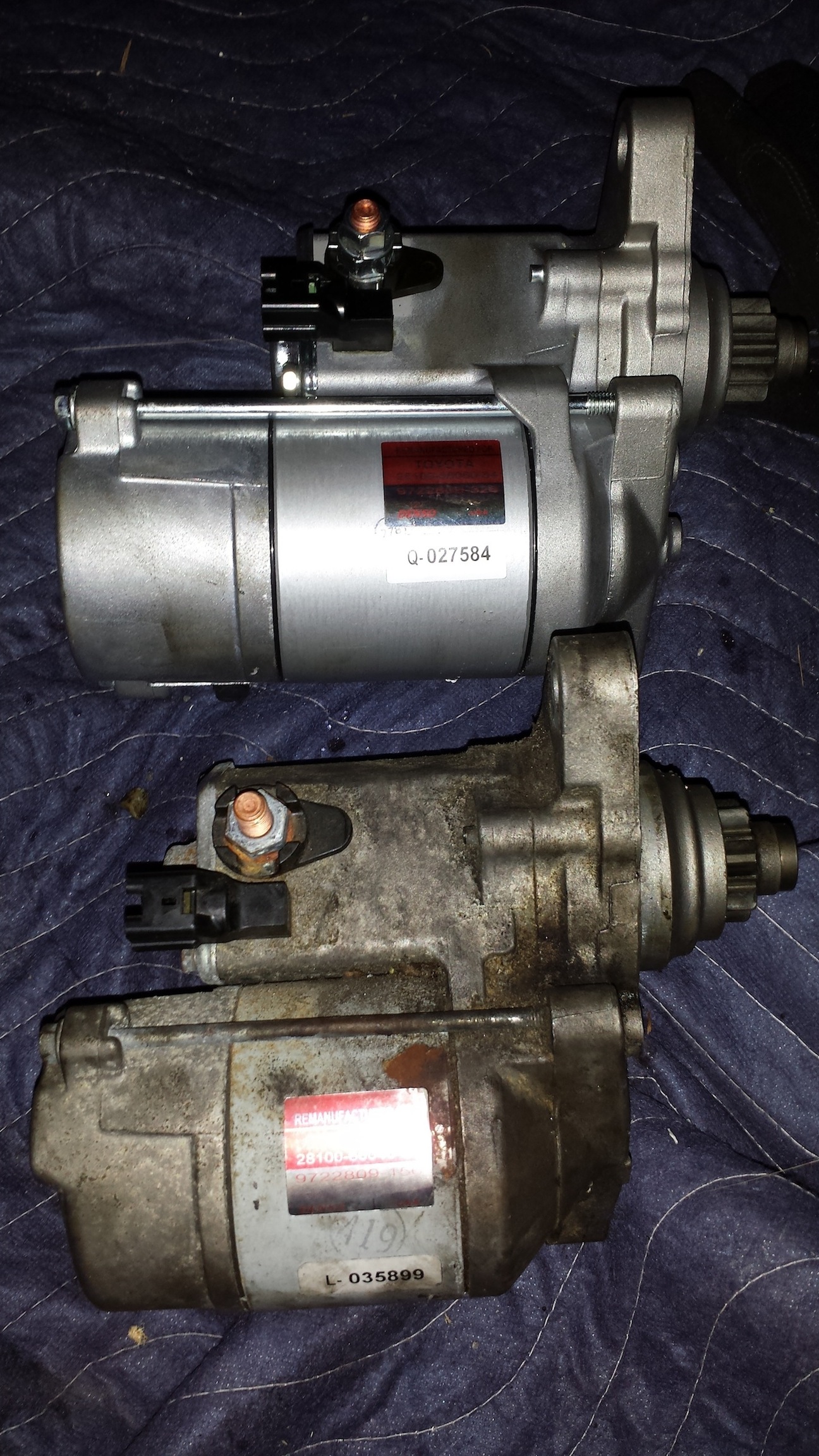

I installed a new starter. was having problems starting the rig and i had enough. it took me about 1.5 hrs. now back on the road. one thing, the new starter is bigger than the old one. no complains here. it works great.
...disconnected the negative wire on both batteries. then sprayed some DW40 to make things a little easier. there are two 17mm bolts . one on top and one on the bottom of the starter. right were it engage to the flywheel. the bottom one was easier to remove, the top bolt was a pain to get to, but not impossible. once starter is loose. disconnect plug connector and a small nut 12mm for the starter wire. I pulled it out from the driver side wheel well. here are some pics

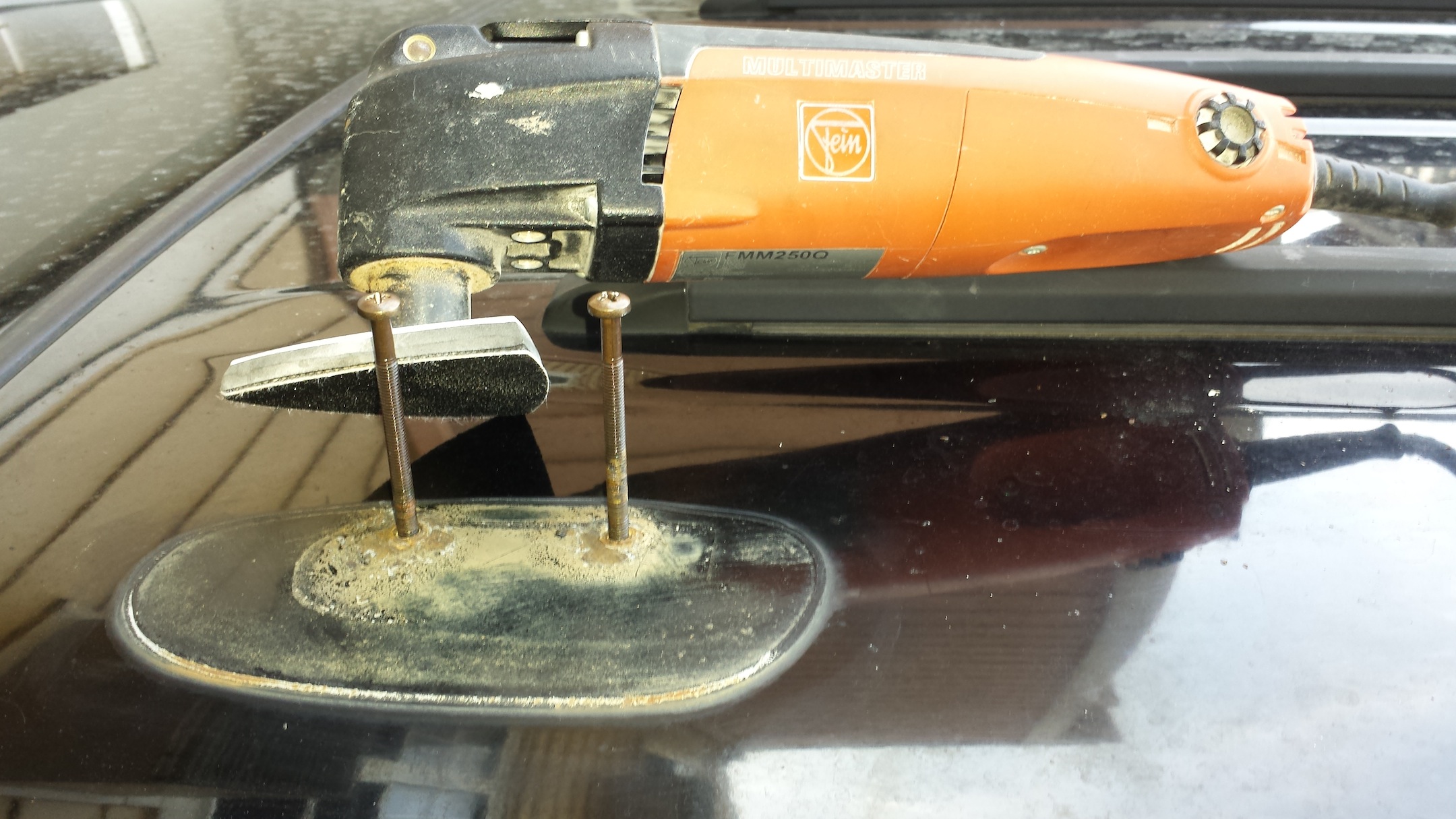

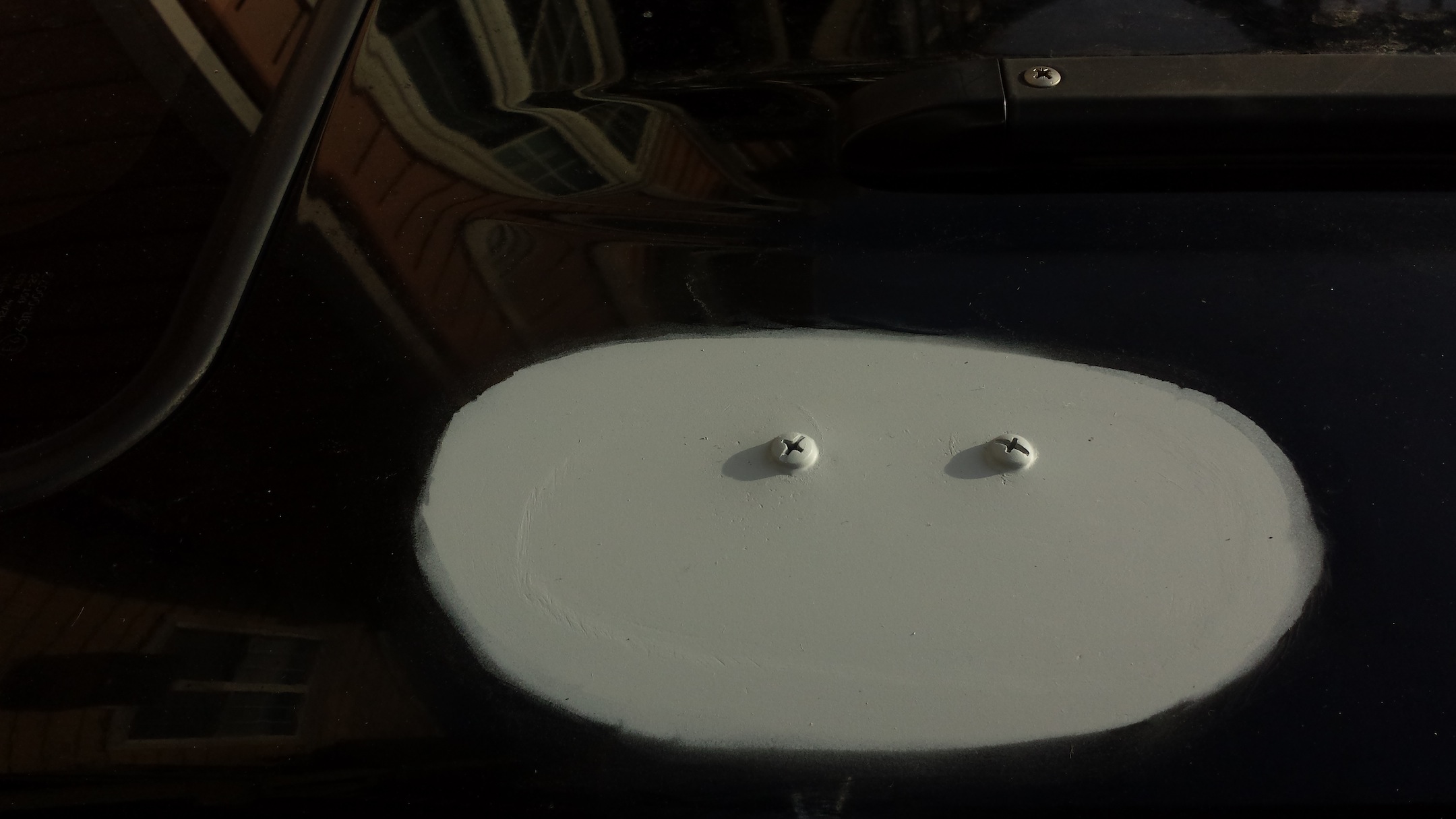

worked on pluging the holes from the OEM roof rack. thank God they were not bad. one gave me a little of bit of work. I pluged the holes with Machine screws M5.8X12MM Pan head combo. Stainless steel. and some J B weld.  ( Home Depot). I need a little more sanding and then some black paint. had to do it today. we had a really nice day. Rain tomorrow.
