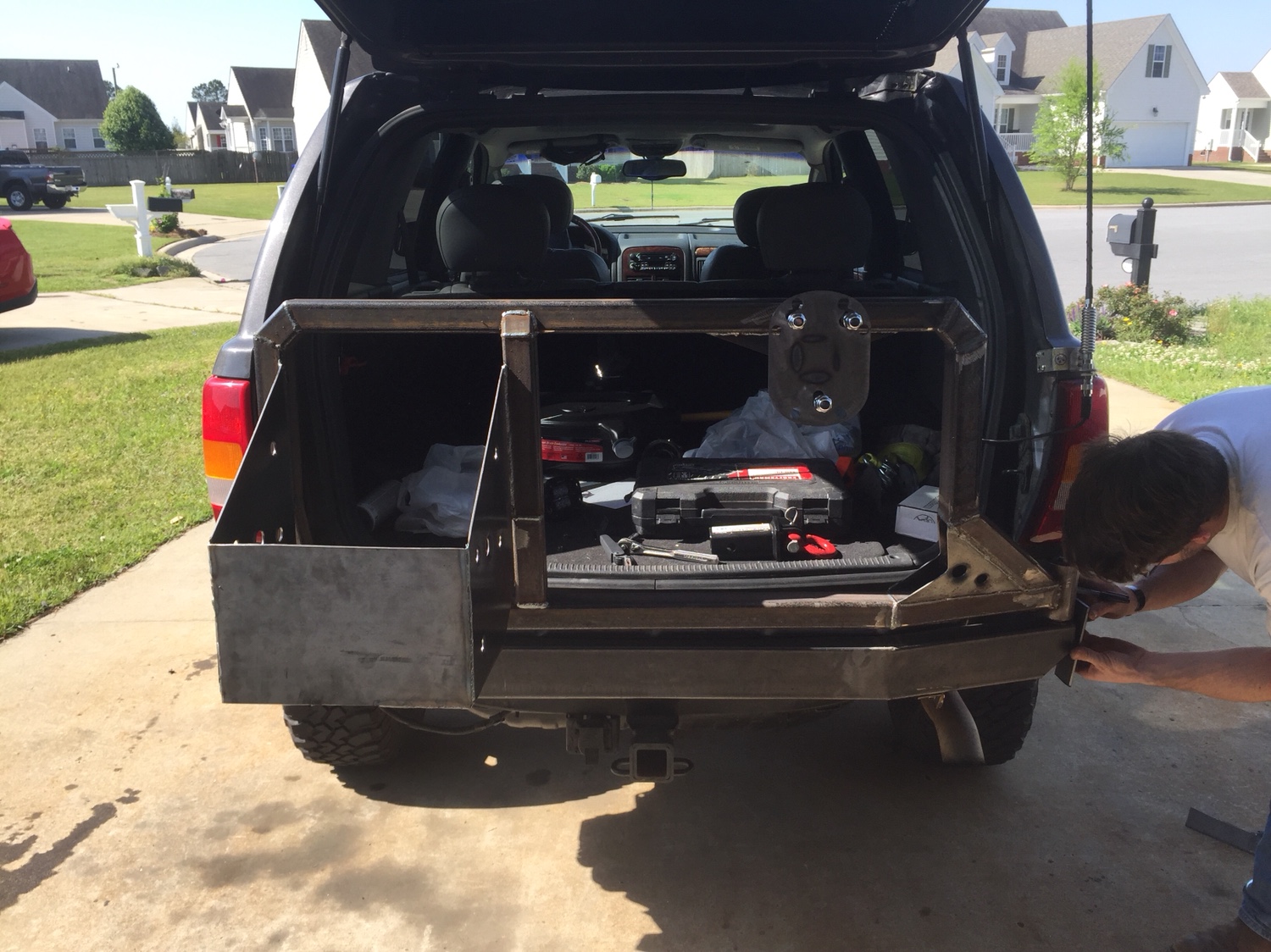

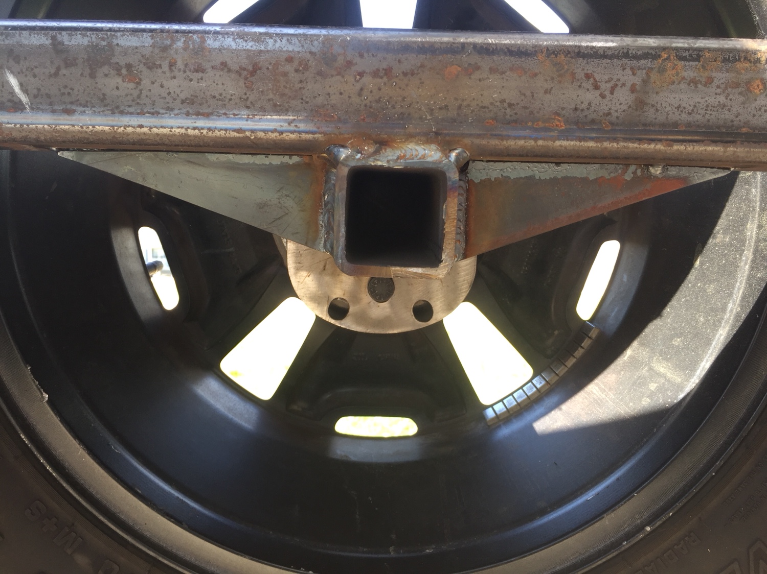

Almost done. There’s a meet and greet Saturday so it’s going to be done by then. It’ll still need paint but it’ll be done.
Hey now...you're covering up the Scuba sticker. :screamcat: and one other thing...how fast can you get to Reno to build me one. :tonguewink::tearsofjoy::sunglasses:

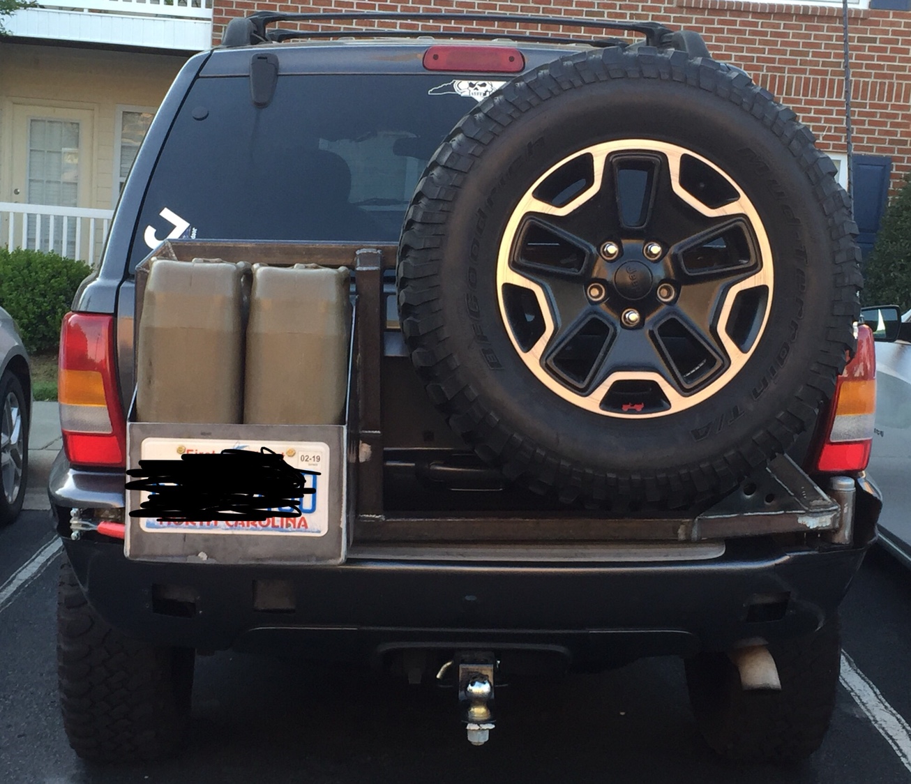

Alright it’s all done minus the highlift rack and paint. It bolts on the left and right sides under the taillights through nutserts. We used 5/16” bolts. 3 on the passenger side, 2 on the driver due to interference issues. The bottom are 9/16” bolts I believe and there are 4 that tie into the hitch. It doesn’t move at all. I’m ecstatic and can’t wait to clean it up and get it painted.
