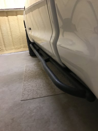

Oh and I only drank a 18 pack to put them on!
