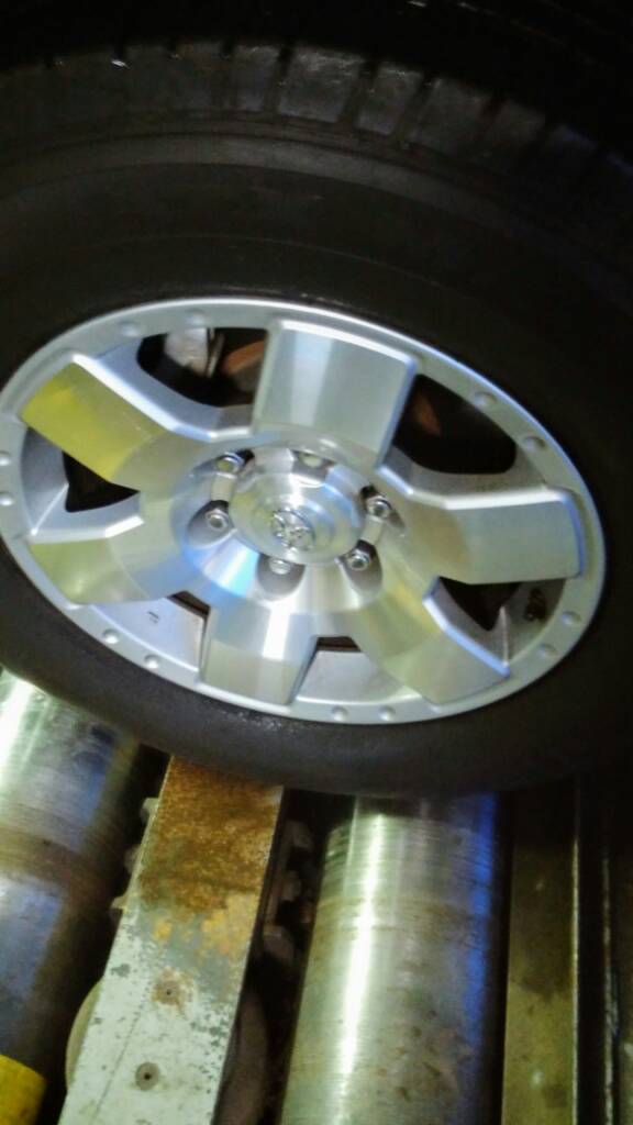

Thanks! I know it's not the most expensive or serious kit out there but the clearance for snow was my biggest concern. I won't be doing any rock crawling so this is a good daily driver/weekend warrior compromise I think!
Here it is after coming off the rack. Still hasn't settled. Will have it aligned tomorrow!

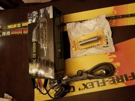

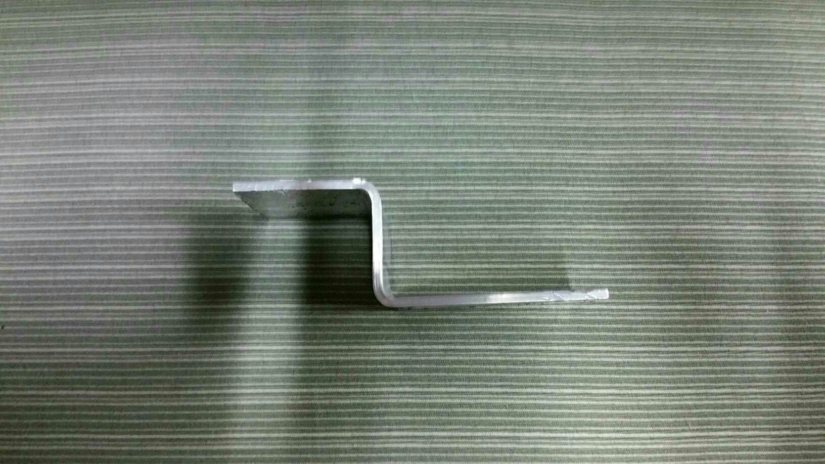

Today I made the mount for my cb antenna (courtesy of @lord_t4r) out of scrap aluminum. Now I need to get the cb that (@O.Dfj) hooked me up with.
Overland Bound Sacramento gang sure is one of the best groups and are looking just like a 2nd family with @O.Dfj being the mommy.

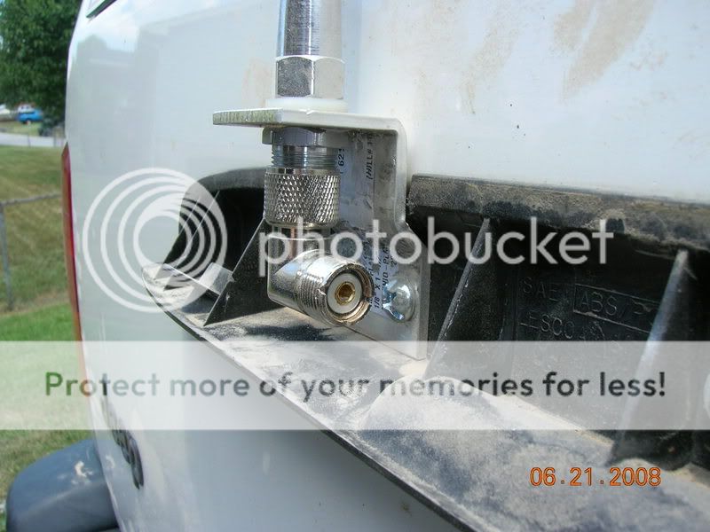

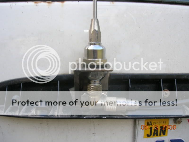

Not sure what kind of antenna you are going to run on that but I built my first mount very similar to that and wound up breaking it through the 90* bend on the first trail after about the 5th tree hit it. I went back with 1/4" steel and eventually 1/4" stainless steel with a heck of a gusset.

Found some pictures!
What I started with:
What I ended up making to solve the issues of rust and breakage. And it's not 1/4", I'm sorry, it was 1/8" angle and a 1/4" thick gusset. Never broke or lost continuity again though and that was with a 102" whip swinging on it for years.
