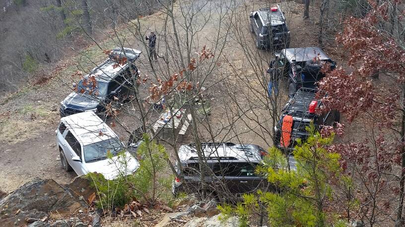

I'm digging that H1Did some trail exploration with some great folks from T4R.org up in Green Ridge State Forest in western, MD
Sent from my SAMSUNG-SM-G870A using Tapatalk
Oh yah. That thing is a beast. The owner did it right with the setup. Very purpose built and well maintained.
