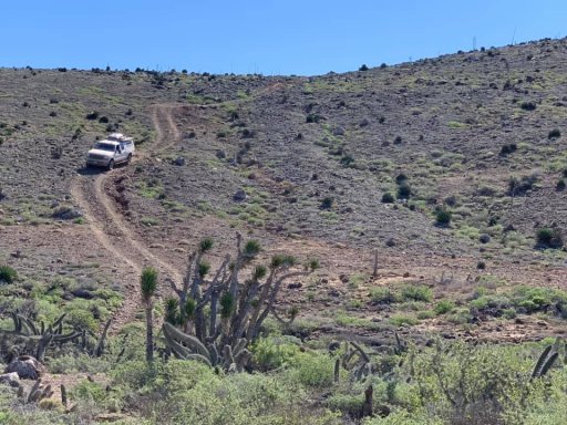

Not so sure keeping it light is good? On our last trip, which was in Baja, our rig was somewhere over 8,700 lbs total with gear and supplies. It did great.
I have gotten stuck a lot in my various 2WD pick ups and most of the time it was when they were empty. I think it is better to have more wieght on the rear axle then is on the front.
Traction and traction.
Just my opinion.
We have a Detroit Locker in our 99 F250 7.3 it is great. With the stock LSD or posi, we got stuck a lot. But with the locker not near as much and it is way easier to get unstock with it also. The Detroit lock was way cheaper and easier to install then an air locker or "E" locker. And on air lines or harness to worry about.
To me a compressor is a most because airing down REALLY helps and it makes the ride much nicer too.

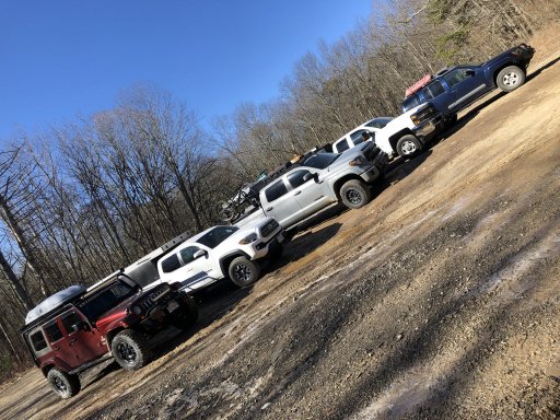

Big thing for me this past weekend was just getting out and driving! Definite confidence booster and encouraging to actually experience the capabilities of my 2wd full size. Went to the meet-up with the Western VA folks on Sunday. @TerryD planned out a trail ride that took us through the George Washington National Forest. A good portion was on easy forest service roads but the afternoon consisted of two track, narrow, water crossings that would have had me turning around if I were by myself. Terry's Xterra in front of me and Brian's Jeep Wrangler behind me gave me the confidence to press on; I think the truck is more capable than I am.
CoffeeBeard
Augusta, GA
Joshua
Emanis
View attachment 143930View attachment 143932
Agreed. Confidence is a must. 2WD can get through a lot with a confident driver. And some buddies to back you up just in case
