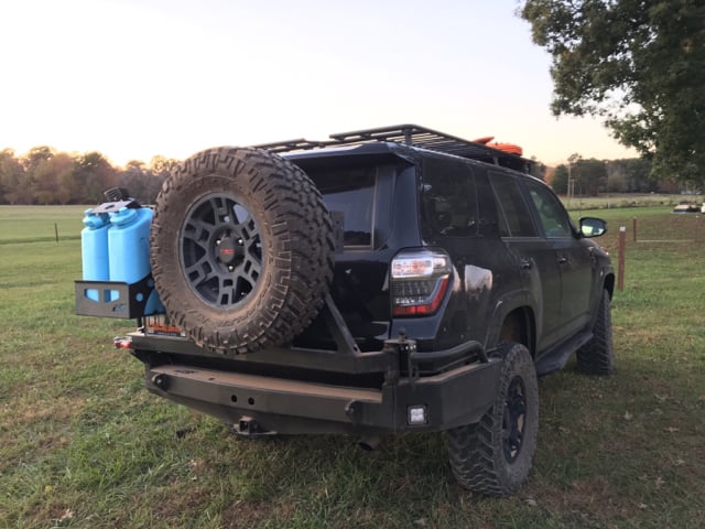

What are people doing for water on board their rigs?
I have a 4Runner with a rear bumper that holds a couple of jerry cans. So far it's been okay. I had a fellow adventurer make me a little electric faucet using a submersible pump. It's genius, but has its flaws. I haven't rewired my rig to have full time 12v power in the rear, so I've got to have the key in the ignition to use it.
I was looking at a Front Runner tank to put behind the rear seats. It would require a pump and isn't baffled.
https://www.frontrunneroutfitters.com/en/us/front-runner-slanted-water-tank.html
Anyone have experience with custom water tanks? Price of Front Runner is $160ish.
