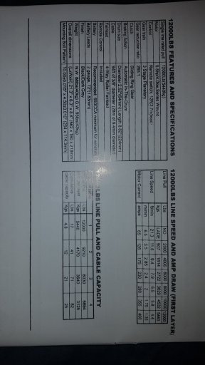

I use a 13k no name winch off ebay. Well actually it has a name just not as well known "costway". The kicker is it will accept the 6.5hp motor the ring gears and other parts off a warn winch. It hasnt failed me yet and i use it around twice a month i trust it to do what i need. Ive played with no name harbor freight winches and like everything else somtimes you get lucky and sometimes you get the one with bad qc but the beauty of buying at harbor freight is if there is a problem return and exchange it no questions.

The kicker with the HF winch is, and I didn’t know it till I installed one for a customer....after reading the manual, it has a Duty Cycle. I don’t recall what it is....something like 15 seconds run time, 10 minute cool down. Now, would I abide by that rule? Certainly not. When you need a winch, you NEED a winch. There’s no waiting. I checked the online O&M manuals for Warn & Superwinch & I see no mention of duty-cycles.
Any electronic motor has a duty cycle some winch companys just dont tell you how long your supposed to do it. Bullet number 4
