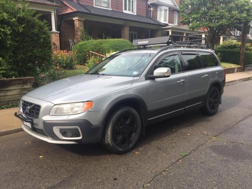

Thanks!
I got the rack from here, the only shop in Europe where I could find it: http://www.ironman4x4.ro/category.php?id_category=919
I like that it’s not as wide as the Pioneer Platform. For a wagon like the XC70 this rack fits really well.

I have the 160x107 version. So far I’m satisfied with the quality. All aluminium with a powder coated finish. I mounted it on the original cross bars which works well but I changed some of the mounting hardware to look a bit better. Original was large plastic nuts but I changed it for stainless nyloc nuts to be a bit more secure.

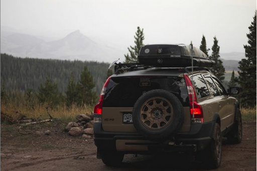

Decided to throw out the emergency spare wheel and added a small compressor. Full size spare planned for the future, just not sure where to place it at the moment.
Could you elaborate on your compressor system? I'm very interested. I was planning on putting a battery/jumpstarter/compressor all-in-one unit into the same spare tire space on mine but this is intriguing
Sure. I salvaged a couple of scrap pressure tanks from work and added a cheap 12V compressor unit and pressure switch from a local low cost auto parts store. There’s a fuse panel on the left side that I connected the compressor to. Works perfectly but a larger tank capacity would be nice.
