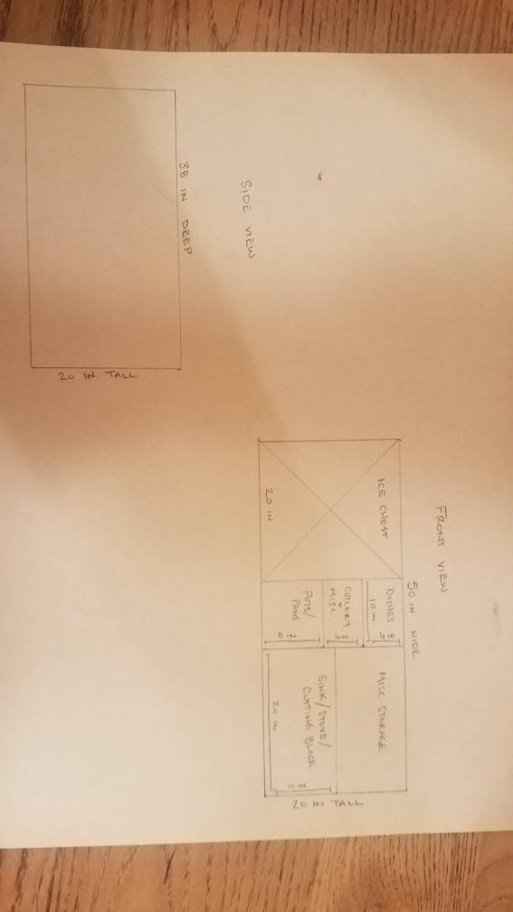

Looking to build a pull out drawer/ kitchen system for my truck bed. I have a 2015 dodge ram 1500. Im including a sketch of the possible lay out. Once the lay out is finalized, a buddy is going to draft it in autocad. Im looking for advice for the drawer lay out. Anybody with (or without) a setup have any advice on any dos and donts? Should i move anything?

Keep it simple. Just build a angle skeleton drawer. The less stuff that can break the better. Also if you are ever planning on putting a fridge in remember the fridge vents. They need a lot of space to breath so you cant have to many things close to it. Made that mistake on mine and the fridge couldn't get cold enough. Also remember places to strap down stuff if you need to.
