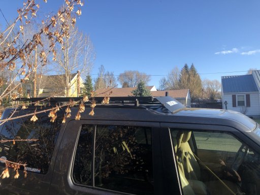

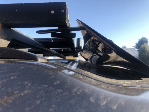

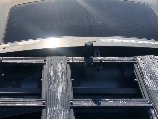

Let's talk about your antenna. How is it setup? Have any pics of it that you can share?
NMO mount is bolted front and center on the rack and the rack is grounded to the chassis. A0D05AFF-940D-4949-A385-66B6A16DC9F6.jpegFE1CC293-1A8B-4392-96C8-7775A4D286CE.jpeg281631D1-9C56-4995-B35A-18BE998D1BD5.jpegA9EC4A47-490B-44D4-9340-90AFD25CF6A6.jpeg

Since we know the radio works, my first suggestion would be to get an actual antenna instead of that GMRS style thing. Even though that low profile is aesthetically pleasing, they get consistently bad reviews for 2m/70cm. Then move your antenna ground to somewhere on the actual truck instead of the rack. If that doesn’t resolve the issue, you will probably want to replace the actual mount and start changing your wiring to the radio.
Honestly, the fastest way to get it all working is to grab a mag mount and throw it up top. I used to hate magnetic mounts but I picked one up for the CB in my Jeep and now I love them. I have a 2’ stick for CB and a 1/2 wave antenna for 2m/70cm. They both perform great and I can store them under the floor of the hatch when not in use.

As far as grounding the mount, I could run a ground cable from the mount on the front of the rack to the rear hatch but it would ground in the same spot as the current ground strap. Is that going to make a difference? I’ve got continuity from the mount to the chassis of the truck.

Is there a problem where it’s mounted, aside from my height issue? I have every intention of getting a quality antenna, it’s just down the road a little way. I’d rather spend money on a new antenna that mounts to what’s already there than a complete mag mount unit.
No problem at all. It's a great location. You just need a functional antenna. Unfortunatly, it's impossible to tell if it's the antenna or the mount that is causing your signal issues. My gut tells me that stubby GMRS antenna is the problem but I have no proof that it's the issue. I think you'll end up with something that folds if you stay with that location.
