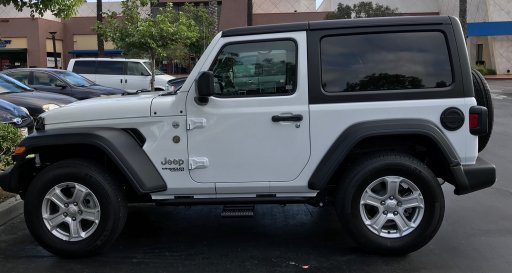

Tires 265/70/R17 on stock wheels no lift 2018 Jeep JL 2Door is good or no?
jcdalman
Lakewood, CA
14198
I am planning of replacing (upgrading) my tires with a wider 265/70/R17 M/T or A/T (BFG K02 or KM3) is it going to rub or I need new set if wheels with offset? currently is a stock 245/75/R17 All season lots of slippage on my first offroad in a washboard and fire road.

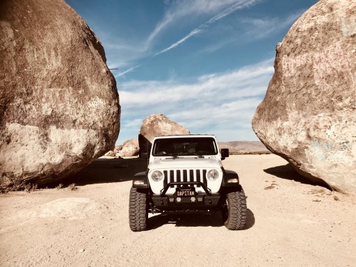

IMG_2178.JPG new update of my jeep finally upgraded tires to Milestar patagonia 33x12.5x17 with American Racing offroad rim with 4.50 BS also installed a stubby front bumper and stealth 10s quadratec winch
