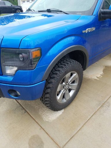

We had DuraTracs on our truck (F150 FX4) and did not think they were loud at all. Our current tires are Firestone Destination. These have more road noise, but it is tolerable. If we didnt find the Firestone's at a great price we would have gone with the DuraTracs.20180802_153119.jpeg

We run 40psi as well. One of the reasons we would have gotten the DT's was that they were quiet, but you can't pass up a good deal (less than $800) on 4 tires.
