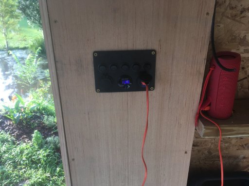

actually solar was pretty cheap. i had (2) 100w renogy panels just sitting in my shop left over from other projects so i just took a piece of pipe and cemented it in the ground and made a frame from left over unistrut and welded it to the pipe. If i had to purchase the items, it would be about $100 per panel and roughly $40 for pipe and unistrut. i ran that thru a charge controller made for a lifepo4 battery. The controller was $40-ish and a 50ah lifepo4 battery was around $300. i could have used a agm battery for around a third of the cost, but i wanted to try lithium and figured now is good since i can have it outside in case it catches on fire.
i then ran off the battery to a 12v switch panel i got off amazon for $35.
it has 5 rocker switches for lights, fan, etc and USB charge ports for phones and a voltmeter for seeing how the battery is doing. then i just bought various led lights off amazon and i went with a 12v radiator cooling fan because they are pretty well built and move a lot of air for a good price. seems like any 12v fan for boat or RV has a crazy high price when the radiator fans move more air for a lot less money.
200w with a 50ah lifepo4 does great running lights, fan and other small items like speakers and charging phones. the wife does pottery and wants to set up her pottery wheel out there, so i will run power for that, but otherwise, the 200w and 50ah battery does well.
