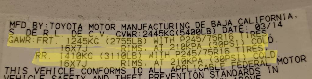

Maybe I'm just missing something, but how do I best determine if a tires Load Carrying Capacity will be sufficient for the truck plus any add one's that we are thinking of possibly getting?
To my understanding, the tire under consideration should equal or exceed the OE load specson the Tire Information Placard (TIP).

You want to keep an eye on the gross vehicle weight specified by the manufactuerer.. the GVWR listed above at 5400 lbs. That's the max overall weight Toyota approves for your model, including passengers and cargo. I think typically you just split the number by 4x to give you your needed load rating, but in offroad situations you can shift a lot of weight to just a few tires so it gets a little more complicated.
I've never bothered to work any equations out although I'm sure it's been done, in my case I just "up rate" tires a bit, namely for increased sidewall strength to resist punctures, the increased load rating is more or less happenstance/requisite. I believe the Tacoma's ship with P rated tires, not LT tires, so any LT tire is going to be safe in terms of a working load.
