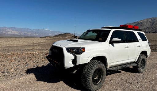

My build has been underway for almost two years. I am super happy with most all of the components. So far:
- Nguyen Works - low profile rear bumper
- Rago Fabrication low pro front bumper with viper cut and a Warn Zeon winch
- icon stage 7 suspension, Eibach leveling kit
Those are the bigger items. More soon.

Just picked up the truck after a handful of items. The most substantial change was a re-gear. I went from the factory 3.73 to 4.56. It drives like a new truck.
A while back I went to 285/70/17s, up from the pen 265/70/17s. The OEM tires were 31.65”. My 285s were K02s, so the were 32.7”. It didn’t need a re-gear with this change, but it was definitely a bit slower and hunted between 4th and 5th on hills.
When I re-geared, I also moved up to 285/75/17s. This pushed me up to 33.9”. The T4R feels more snappy now than it did with the smaller tires and factory gears.
Stay tuned for more thoughts after I get additional miles.
